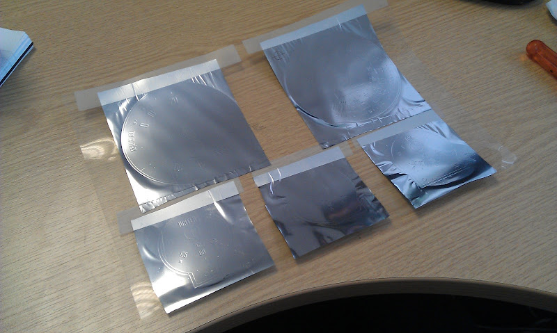

Im changing the numbers on my dial design based on the Smiths Mini Classic dials. I also wasnt overly happy with the amount of light bleeding through the background on the dials when illuminated so I have added an extra 'mask' layer to these ones that is silver foiled to block the light.
Cant wait to see how these ones turn out. :cool:
Stot 5th April 2013 01:49 PM
I also had a go at making a new insert for the warning lights in the cluster because they would be upside down otherwise. Same process but omitting the paper layer.
The parts,
Layered up,
Light from behind.
I havent stuck these together yet but its looking promising.

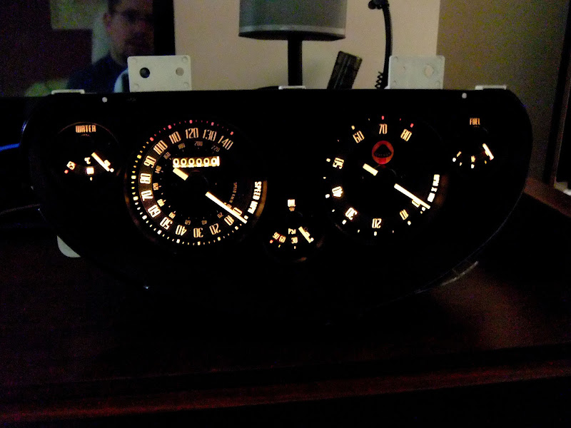

Stot 6th April 2013 11:28 AM
MK2 dials. Based on the Smith mini speedo.
Much more retro looking I think, and the illumination doesn't bleed anywhere near as bad!
And the warning lights work a treat. :cool:
Not Anumber 6th April 2013 02:45 PM
These are seriously good.
You could think about sharing your set up costs by making sets for other builders. A lot more cost effective than spending out on Smiths dials to achieve the same result.

Stot 6th April 2013 07:34 PM
Theres way too much work in them for me to do that really. To make a set takes upwards of 3 hours to produce + design time. I must have put over 20 hours of design into these ones and made 3 sets of these Smiths ones before I got them right. :eek:
They cost me £15 for 50 sheets of acetate, £9 for the spray glue and £4 for a craft knife and hole punch set.
MX5Nuts guy is doing them for £35 a set.
