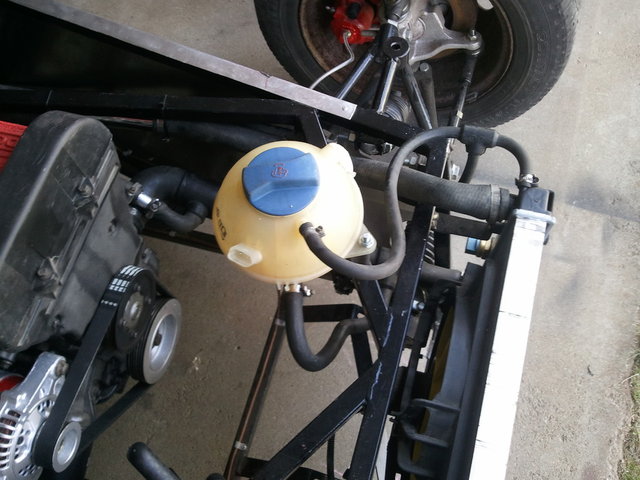

Hi skov are you using a polo radiator. If so is it from a mk2?
What type of expansion bottle have you used? All the ones I have looked at seem to have too many outlets.
thanks
David
skov 24th October 2012 06:54 AM
Hi David,
Radiator is VW Polo 1983 - 1990
Expansion Tank is VW Polo 1981 - 1994
Davidbolam 24th October 2012 11:18 PM
Thanks.
Does your expansion bottle have more than one outlet? The ones I have searched appear to have 2. I have looked at your photos and I can only see 1.
If there is more than one outlet how did you plumb the second outlet in?
David
alga 25th October 2012 12:46 AM
All VAG bottles I've seen have a ~16 mm outlet at the bottom and a 8 mm inlet at the top.
Mine's from a Škoda, but exactly the same one has been used in Golfs, Passats for about a decade.
skov 25th October 2012 12:58 PM
Mines the same bottle.
I've got the 16mm at the bottom Tee-d into the heater matrix hose, and I think I'm going to link the smaller outlet at the top to the small outlet at the top of the radiator.
skov 25th October 2012 11:56 PM
I decided to get that top outlet hooked up this evening whilst I was thinking about it.
I used my left over copper fuel line with a couple of short bits of hose either end to go to the tank and rad:
