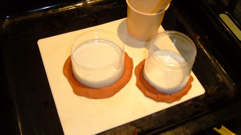

Just for you guys, heres how to do the rest of it without a CNC machine. :rolleyes:
I superglued the photopolymer versions onto some discs of MDF the right size and cut round them then wrapped some electrical tape around to give a clean edge.
Put them in some molding forms and poured silicone onto them, left it to cure and demolded.

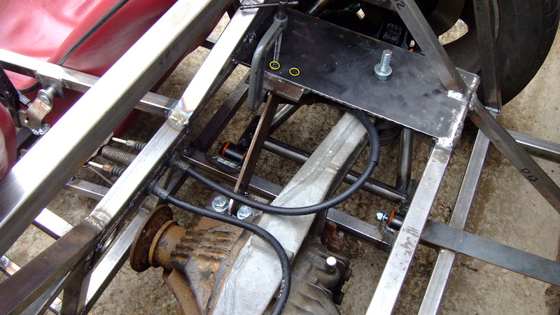

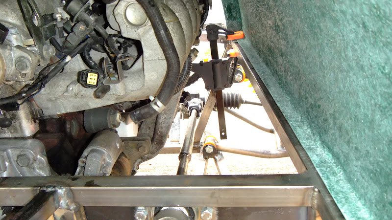

Stot 18th May 2013 06:48 PM
Hi All,
I got some real car stuff done today. I wanted to mount the diff and get the engine in. I did OK.
I got the engine in and in position with the sump ~40mm below the bottom rail. It may be a little lower but thats OK. I can always shim it up under the rubbers If I have any problems and I plan to shorten the sump at some point.
Saying that with the bonnet in position I couldnt have got it any higher anyway!
Where it is positioned it is not fouling the steering column either.
Stot 18th May 2013 06:51 PM
Diff went in easy enough.
I will be putting 2 holes where the yellow circles are to bolt the nose hanger I made in.
I could weld it but the diff is hard enough to get in and out of the cage as it is so being able to unbolt it will be great.
