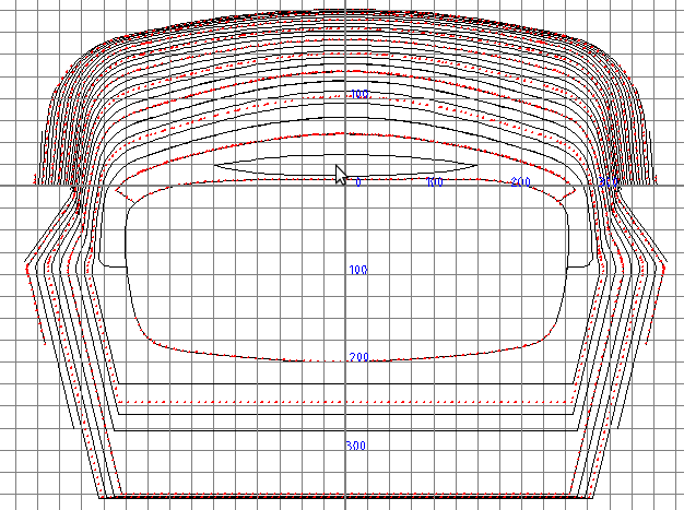

Doing your own GRP is definitely a cost saving measure. The materials account for about 20% of the price of commercially made GRP panels. To save time and money, make a one off nose without making a female mould. Laminate glass on the buck, then auto filler and paint.
You can use this plan to make a buck of the size and shape of the Triton/SSC/Gillham nose:
http://locost.lt/download/file.php?id=385
25 mm squares, the black lines correspond to 20 mm slices, the red dotted ones are 50 mm apart. I have the vector version somewhere, too. I used the cheapest polystyrene foam and some plaster putty compound on top to protect the foam from the styrene in the resin.
