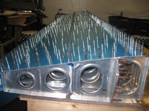

Something along the lines of this?

Exactly Steve cleco heaven,but they use proper "rivets" .;)
