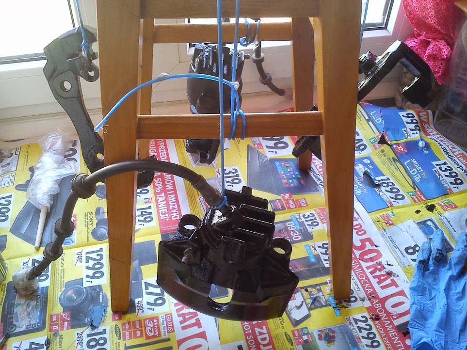

Front calipers (Mondeo MK2 2,5 V6 278mm discs) - painted and ready :)
