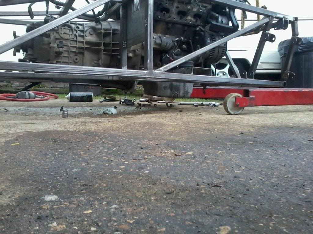

michael92 3rd July 2011 09:58 AM
Fly like a v6
howdo chaps!
well just a lilttle diary update :) recived my suspension brackets from Talonmotorsport very nice! and my rack extensions from
Dave @ rogue engineering nice bit of kit too :-P
but the real bargain lies here . i managed to get my engine in a complet running order with gearbox, loom ,ecu, flywheel, clutch ,sensors the lot! for......£60!! also got my gear remote so i have been sitting in pretending to change gear!! ;-)
Dont ask how that got in there!! it was difficult!
start of stripdown , oh and the engines only do 70k!
I have some big development plans for this engine, which i will probably regret having "too" much power haha but more power more fun right ?

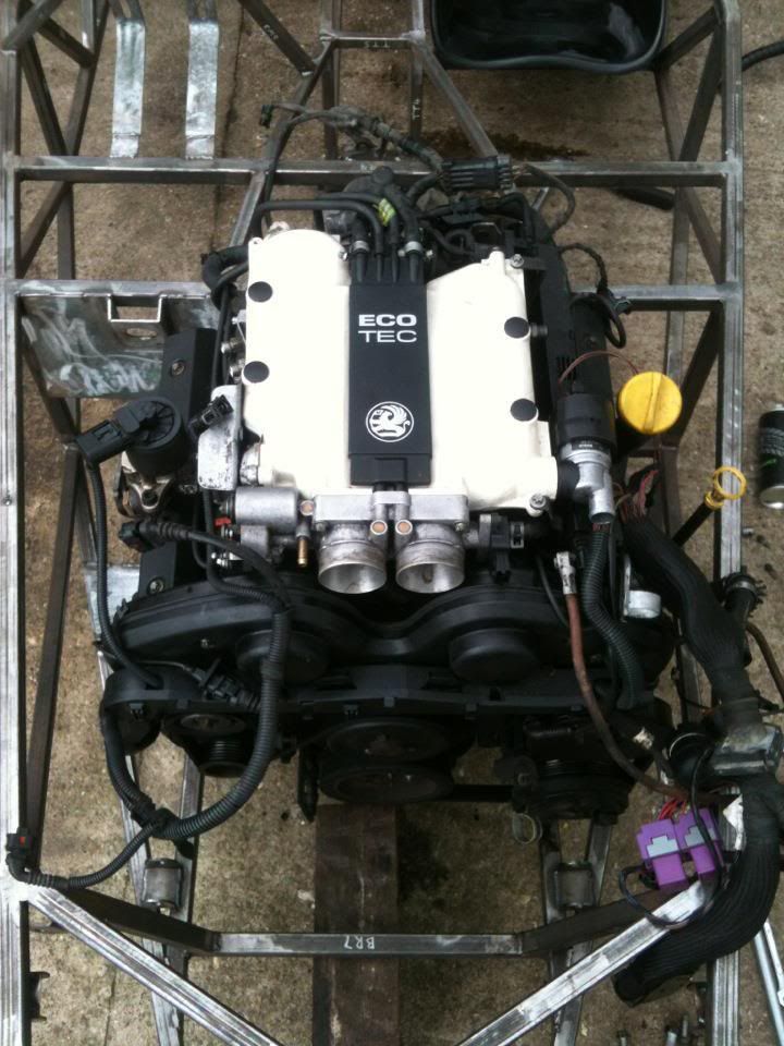

michael92 24th July 2011 05:55 PM
engine update
hallo,
lately i havnt been doing much chassis work! but i have been tinkering with my engine in time.
still needs a rehone then thats it! oh and a gasket set! but its all ready for assembly then!! :-D
zu den Bildern schnell!
hope you enjoy, as i must say the blue is a nice colour :-)
Michael

thank you :) , erm well as a young bloke i have no colour co-ordination. i did want the car lime green! but we will see haha knowing me i will have it lime green and keep the engine blue haha!
although! my inlet plenums are going to be white (the ones pictured) and then the center air runner that will be yet again blue :)
I think it will look good :)

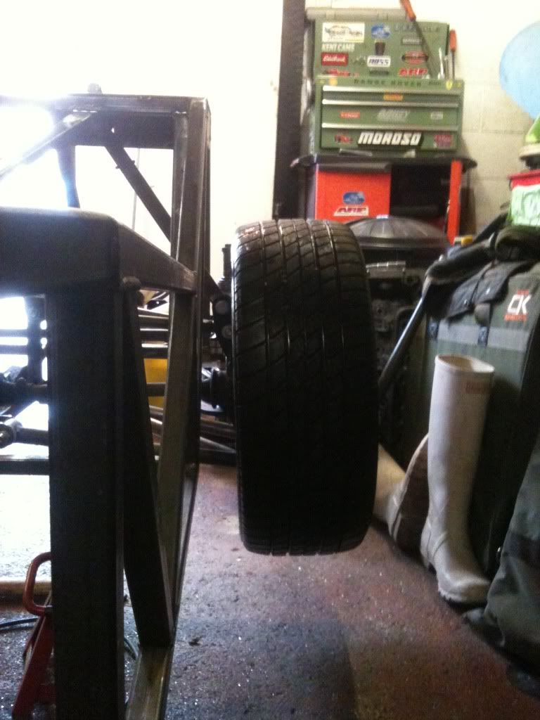

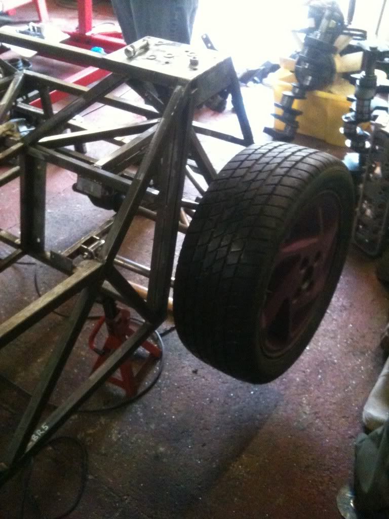

michael92 2nd January 2012 04:22 PM
Its been a while :) but ive made some progress!
order'd some mushrooms from talon and as soon as i get them thats my front on wheels just need rear ups and a steerring rack then wala! rollllinggg!!! :-D
a bit confused on how the sierra steering bush fits , but ill have a quick search i reckon!

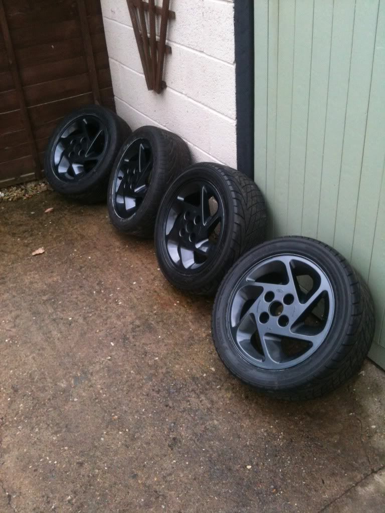

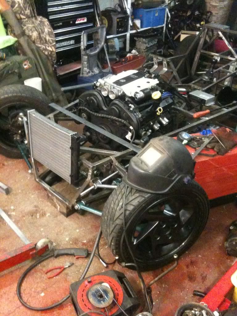

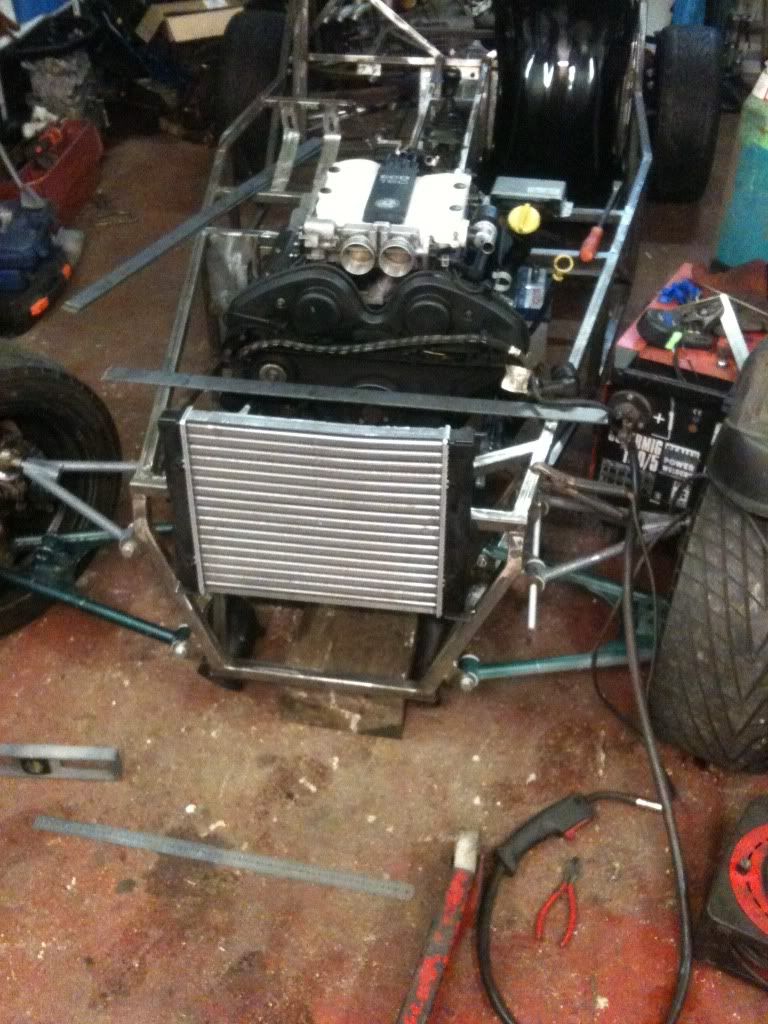

michael92 21st April 2012 02:50 PM
well.. thats the ac an pas pumps ditched! much more room! things are starting to look good :-) Fitted my tyres at college yesterday and my oh my!
wowzers... did a mess in my trousers ;-)
on das front are a set of yoko advan neova which i won for 60!! bargain!!
and on dee back are a set of toyo proxies t1r's ;-) £30!!
and my friend did the spraying on my wheels which im very happy with!they are in a kind of grey metalic, looks real nice when the sun hits them!
thats the rad fitted this morning :-) now to do the drivers seat and other bits i have missed i reckon.
does the height on the rad look ok to you guys ?
Mike
K4KEV 21st April 2012 04:02 PM
nice work so far bud....the rad does look too high ...the rads position is determined by trial fitting the nosecone as the rad sits inside of it.

and as for the rad it is far far far to high! so that will be coming down 3 inches or so!! :p
michael92 21st April 2012 06:37 PM
thanks for your kind words :) yeah , im going to be loweing it quite a bit and maybe put it on a slight slant. i was literally going by the rule of "aslong as its under the engine" haha but i spoke to andy and he said and liek youve said the bonnet has some depth on it :)
