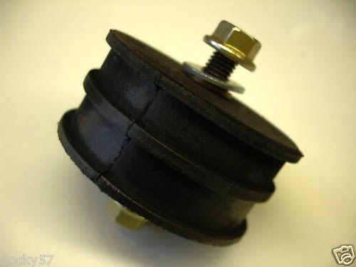

adrian you say about engine mounts needed are land rover 1s can you be more specific or link me to a pic of them.
my reason for asking is that jezzer is selling a set of engine mounts but if they can be fabricated or picked up relatively easily then i dont need to worry about them at the moment

The landrover engine mounts are nothing special they are just two lumps of rubber with an M8 stud on both sides, they can be found on ebay for £2.40-6.00 each.
