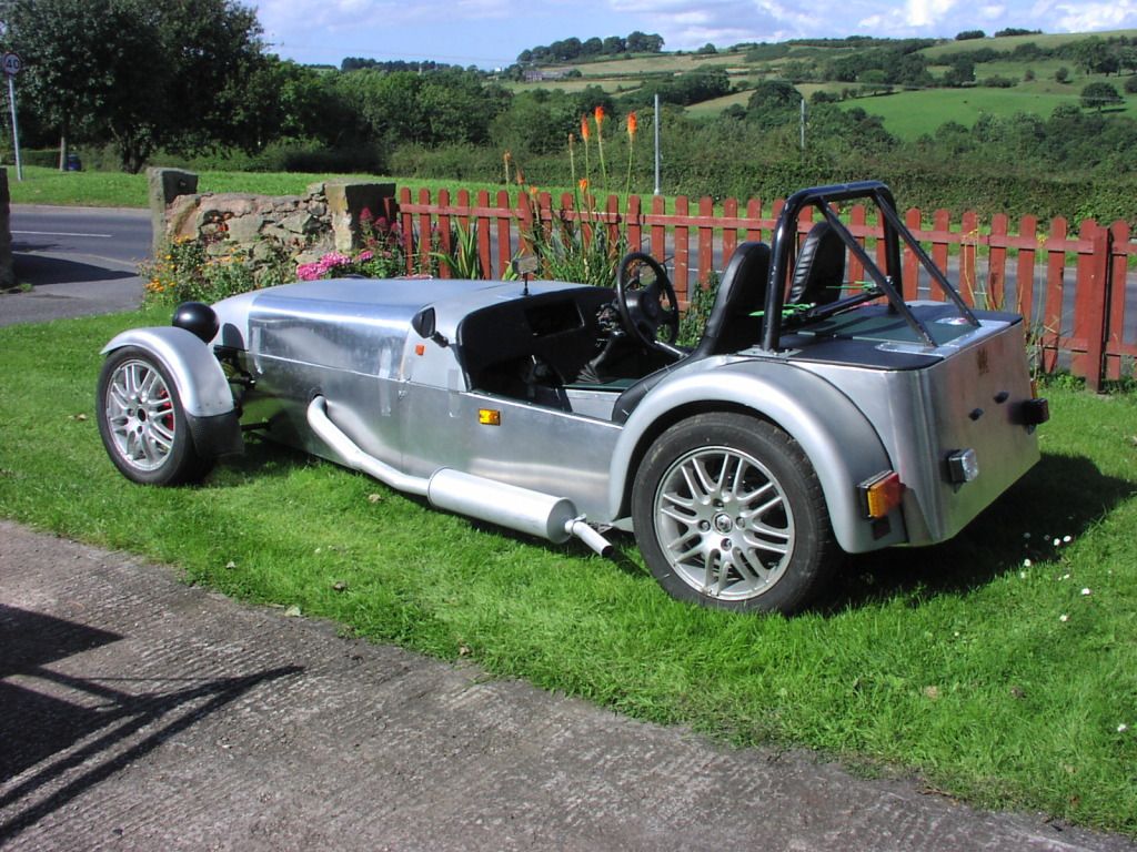

HandyAndy 15th July 2012 07:18 PM
WoW Ayjay
Thats some fantastic progress you,ve made , car is looking great :cool:
May I ask....are they the side repeaters or side reflectors fitted to your side panels ?
Reason I ask is come IVA time they may not be high enough for the rear vision check, I,ve heard that some cars have failed with them fitted to the side of the scuttle as the rear wings obscure the repeater , & yet some have passed :confused:
Looking great :cool:

ayjay 15th July 2012 10:18 PM
Cheers guys.I've just been plugging away quietly in the background:)
I thought I'd stick those pics up to encourage others who may be flagging a little at the mo judging by the recent posts.
In other words--"If I can do it--- if you feel in a bit of a rut with your build then take heart"
The orange bits on the ali side panels are reflectors-- it seemed like a good idea the ind. repeaters will go on the side of the scuttle.
Its been a bit of a slog and sometimes its been one step forward and two steps back.ATM I cant get the brakes to bleed . i had a leaky master cyl. which filled the drivers side floor with fluid whie I was on holiday and stripped all my paint.:mad:
Then my battery leaked acid all over the scuttle and into the passenger footwell.:mad: The pic.shows no. 2 scuttle panel ready to re- fit all the electrics.

ayjay 14th August 2012 04:02 PM
Nearly there.Two years ago this week the notion of building this sprang into my head. Started I think Nov 2010 Needs tarting up and making IVA friendly .Also dash needs finishing(Anyone got a suitable piece of perspex they feel the need to dispose of would be greatly appreciated.
ayjay 14th August 2012 04:06 PM
ayjay 14th August 2012 04:11 PM

TheArf 14th August 2012 08:35 PM
Its looking well tidy mate I will give you a bell during the week and pop up to catch- up
twinturbo 14th August 2012 09:31 PM
GAFA tape bonnet fixings may fail the IVA ;)
Looking good, hope you get it on the road before the winter sets in :)
ayjay 14th August 2012 09:47 PM
Yep --Toying with the idea of vinyl wrap so holding back on the fixings ATM:cool:
