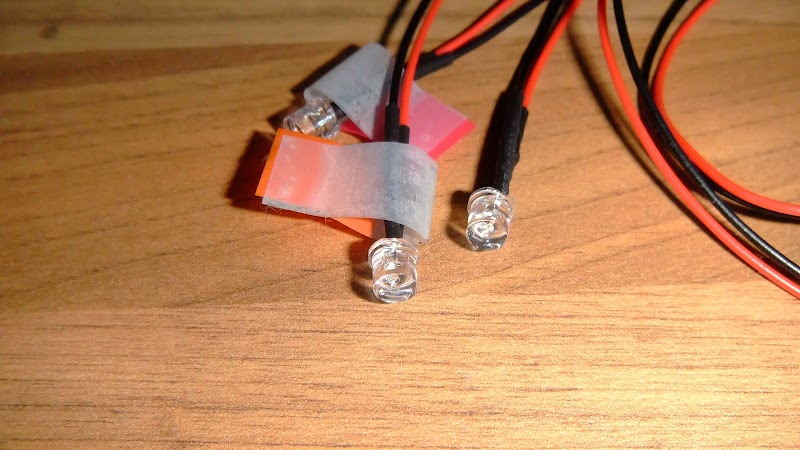

I got some wide angled LEDs and some chrome panel mounts for them. The LEDs were too piercing as they were so I sand blasted them to diffuse the light more.
So I have the ingredients, now I have to put them together!

You'll be glad you have piercing LED when trying to read the indicators in broad daylight. The Sierra cluster's indicators are impossible to see during the day.

They were like lazers to the eyeballs before I blasted them. They are a nice bright all over glow now. I wont miss them even in bright sunlight. :cool:

Another idea for the warning light logos.
These are only 5mm but they are easy to make out and not too bad as tests go.

What you can do is connect a relay so it's coil is fed from the sidelights. When the relay is off the panel lights are fed from the full 12 volts going through the n/c contacts on the relay. When you switch the lights on the relay switches over to the n/o contacts which have either the 12 volts via a resistor - or preferably - through a voltage regulator of about 5 volts. Hey presto - bright lights during day time, dim lights as son as the side lights go on. Remember though that some panel lights eg handbrake warning lights are switched negative.
