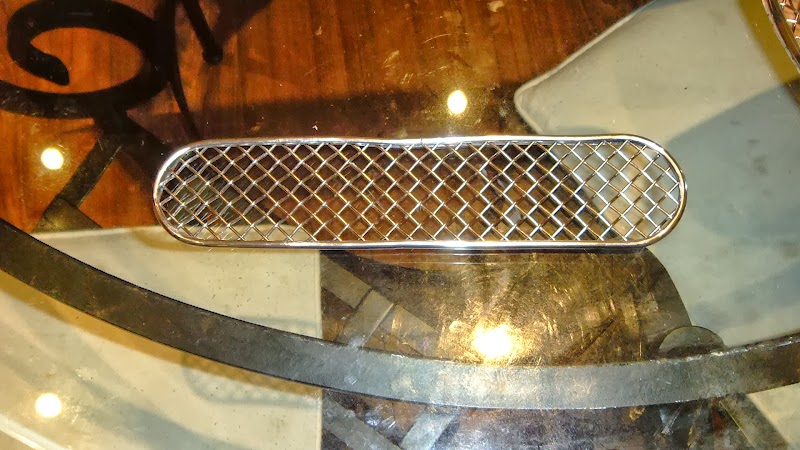

Got my chrome U trim today. Its not flexible at all along its length so I couldn't wrap it round the edges like rubber trim so I had to come up with another idea.
It comes in a coil wrapped sideways so I decided to trim one side off so that it was more like a J section that a U section. To do that nicely with an even cut all the way along I made a little jig out of some scrap MDF.
The profile was cut/filed into the MDF so that when put together the trim could pull through it. I used a piece of breakaway blade in the middle and clamped it all in a vice. Pull the trim through and voila, perfectly straight cut for the full length.
Stot 24th October 2013 11:10 PM
Super-glued it around my grilles and it looks the biz. :cool:
Stot 25th October 2013 10:27 AM
Not fully screwed in but as good as I had hoped.

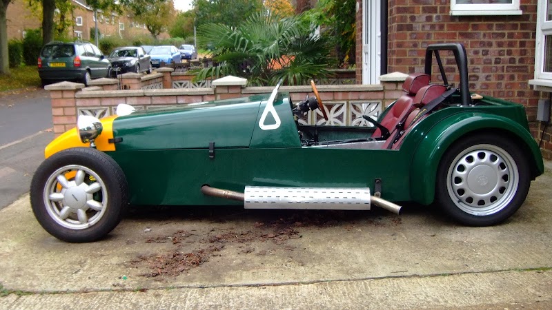

Still need wiring but good progress this weekend. I even managed to first fit one of the front wings before I lost all the light.
I need to figure out how I'm going to solid them up now. Probably going to be a bracket that bolts on to the headlight brackets up front. Thats how Lotus did it soooo...
Still not sure about IVA for these.
davidimurray 29th October 2013 02:53 PM
Have you checked them against the template in the IVA manual. They look like they might be a bit short on the front edge.
Stot 29th October 2013 04:40 PM
Yeah the 30 degrees bit is what would fail it, I cant get them any further forward.
I may ask someone to lend me some cycle wings for the test...... Anyone reading?..... Ill make you a bonnet badge.... :o
