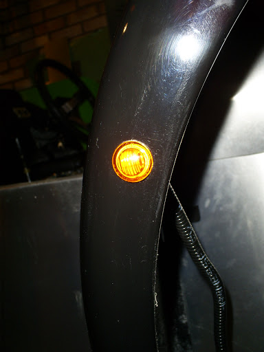

That's my side repeaters fitted. I went the little round LED ones in the rear wings:
Whilst I was at it I fibre-glassed in a couple of cable-tie bases each side to hold the wires in place:
