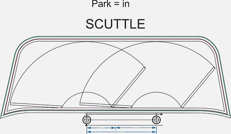

Stot 2nd August 2014 10:25 PM
Yeah I was chuffed with the price. 6.4mm laminated glass and they ground the edges too.
Wiper positions and lengths are taking some calculating but I think I have it cracked so to speak. My windscreen is quite shallow so I have to use 8" blades and 6.5" arms but it should work out.
Wiper boxes mounted with the rack at the bottom and the wiper motor under the passenger scuttle.
Stot 5th August 2014 10:14 PM
Got my wipers in place tonight.
Just need to find a way to mount the motor now but the sweep on them works out well.
