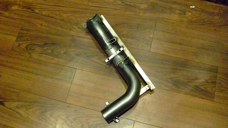

Stot 18th November 2014 07:54 PM
Got my downpipe sorted today. Made a frame from exhaust brackets and 20mm tube then cut and welded bends n flanges.
I have an O2 bung to go on the lower section and its done.
Stot 20th November 2014 02:08 PM
That fit quite well.
