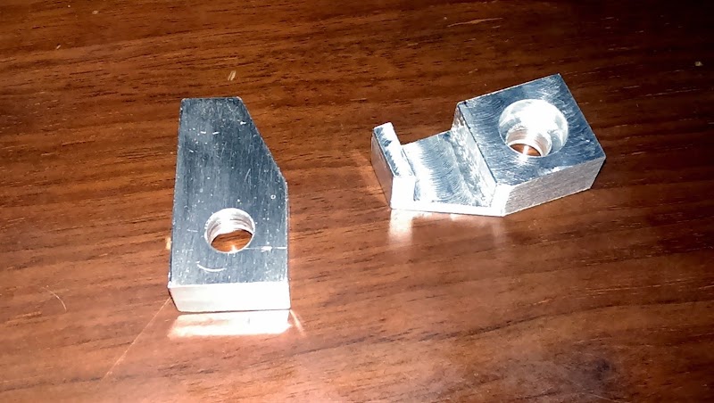

Adding a turbo isnt cheap but im still trying to save where I can. The injectors of choice for an MX5 turbo install are RX8 440cc yellow injectors. They are a straight swap for the OEM injectors but of course, as this is a known thing, sets of used dirty injectors are £90-£110.
Turns out that Subaru WRX blue injectors are 420cc and are the same as the RX8 yellows except they are 9mm shorter, but a full set cost me £20. I paid £55 to get them re-coned and flowed and im still quids in against the dirty RX8s which would also need re-coned.
Making up some new brackets for the OEM rail seems like a no brainer to me as I have a mill and alluminium so I cut the old mounting tags off the rail and made up these,
CTWV50 1st December 2014 01:01 PM
Originally Posted by Stot (Post 99391)
Adding a turbo isnt cheap but im still trying to save where I can. The injectors of choice for an MX5 turbo install are RX8 440cc yellow injectors. They are a straight swap for the OEM injectors but of course as this is a known thing sets of used dirty injectors are £90-£110.
Are you running those injectors at 3 bar? Have you upgraded the fuel pump?
Stot 1st December 2014 01:37 PM
Yeah at 3 bar they are 420cc. The standard fuel pump is fine if you are using an aftermarket ECU rather than a higher rate pressure regulator to provide more fuel. It can pump up to nearly 6 bar so 3bar standard + 3 bar of boost if youre crazy enough. :D
