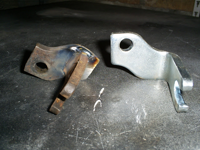

Sorted out my handbrake cable interference issue by cutting and rewelding the brackets that hold the cable ends on the caliper. Should bring the cables away from the chassis by about 1/2 and inch.
Only tacked together in the photos, but you get the idea:

Stot 29th June 2013 06:48 PM
Hi Skov,
Looking at that I cant help but think it would be a safer option to shorten it this way. It looks like it would still line up ok.
lol, don't know why I didn't think of that!

It wasn't touching at all when I checked (but was damn close!), by the time I got to IVA they were hard up against the seat backs all the time.
I had the cables pulled away similar to you, but they still managed to move and settle upagainst the chassis.
Seems to be sorted with the shorted brackets anyway.
