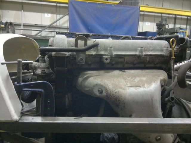

Your build's looking great Johno :cool:
If that doesn't hold the diff in place, I'm not sure what will! (triangles perhaps? :p )
Don't know how you got so much clearance under the bonnet :confused: My manifold was still touching the bonnet last time I had the engine in!

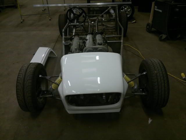

Not so sure about that top wishbone. That piece of studding has got shear in every plane and might fail. It would be better to adjust it on the inner bushes and keep the itegrity and strength of the original design on the outer joints. At the end of the day that studding will be getting hammered over every bump and hammered under acceleration + braking. Just thoughts. Think Toblerone
Bob

Thanks Robo,
Gonna re-think top wishbone but would still like to keep it adjustable.
Do you think it's to weak solely because of the threaded rod? I was planning to change it with a machined part with threads both ends and a majority of the body inside the bush just machined to suit the insert with a close fit.
I've used this setup for now just to determine my rear geometry so still playing with it. Missus won't let me have shocks yet....:confused:
I know Westfield and others fit top adjusters with Aluminium inserts and have had failures and I believe Ash G had the same problem so hoping this would be stronger.
Thanks for your advice Johno

Johno 8th April 2012 08:52 PM
Hi Skov,
We put our engines in according to your measurements and Andy from Saturn. Our sumps are 40mm lower than the chassis rail which doesn't seem too bad, so if you want me to measure what we have now just let me know. Luke has placed his engine in today so we can check his as well. We are all using 1.6 litre engines so all should be the same.
Johno
Johno 9th April 2012 09:23 PM
Hi Skov,
Luke put his engine in yesterday and his engine clears as well...:)
It even clears the throttle bkt on the inlet without having to grind it down.
Johno

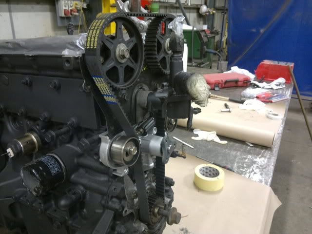

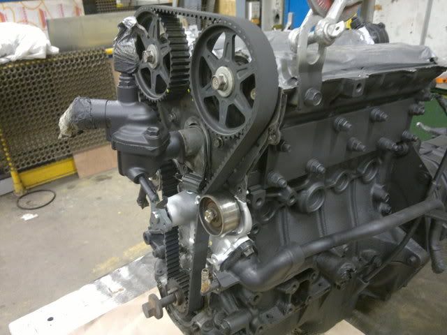

Well engine and gearbox was sand blasted and painted with acid etch then given a coat of VHT paint.
New water pump fitted along with cam belt,

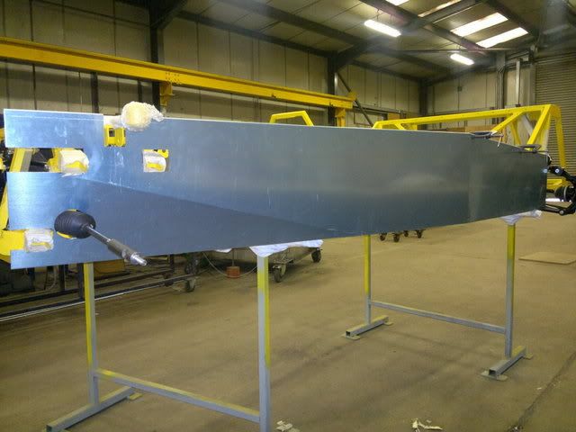

Also made ally side panels,
I made the sides out of 2mm Ally hence the reason I had to put a bend in the sheet to get it to go where I wanted it to.
