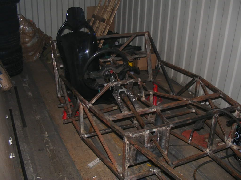

Has anyone got any tips or extra measurements for the steering column support? :confused:
No matter how many times i measure it, I just can't seem to get everything lined up. Are the plates supposed to sit flat against it? Or just meet at the top and weld it on??
Anyone got any close up pics which might help??
It's the first bit of my chassis that doesn't want to fit. :rolleyes:

Mine looks close, but if i get the sides to line up, the top isn't level, and if i level the top, the plates don't reach. :mad:

Just use the plates to set the distance for the support,
You might need to alter the angle where they meet the top rail & the tranny tunnel tho,
Set the plates 60mm apart & then you will find the bracket from your steering column will fit nicely ;) :)
Whilst the support is critical to the steering column, the height of it isn,t as there is loads of space under the scuttle , just make sure its level.
hope this helps.

Thanks Andy. That's what i was trying this evening, but when i tacked the plates to the support and lined up SW1 and SW3 with the chassis, SW2 wasn't level. :mad:

as long as you use the plates to determine the distance & SW2 is level it,ll be fine & dandy :) it sort of "finds " its own position on the chassis rails, but as a double check keep an eye on the height measurement of SW2 from the book, get it as close as you can but ensure SW2 is level.
By the way......is your steering column an adjustable one?

Is the 71 degree angle of the plates not too critical then??

yes it is " in a fashion" so to speak ,
as this ensures that the column will be in the correct position/angle to miss any chassis rails ( TR9 & TR8 ) as it passes in between both of them,
easiest thing to do is get the steering column & place it into position, & thus you can determine the correct position of SW1, SW2 & SW3,
honestly, it makes it alot easier, as it takes away any "guess work" as you,ll see that the column doesn,t foul any rails etc.

Thanks to your help, i managed to get it sorted this evening... however... I balanced a seat in the car (on 25mm box section) and sat in it for the first time, problem is, my eyes are inline with the top of the steering wheel.
After IVA i'll be putting a smaller one on, so shouldn't be a problem, but what about iva man?
Anyone else have this problem? (rack isn't height adjustable).

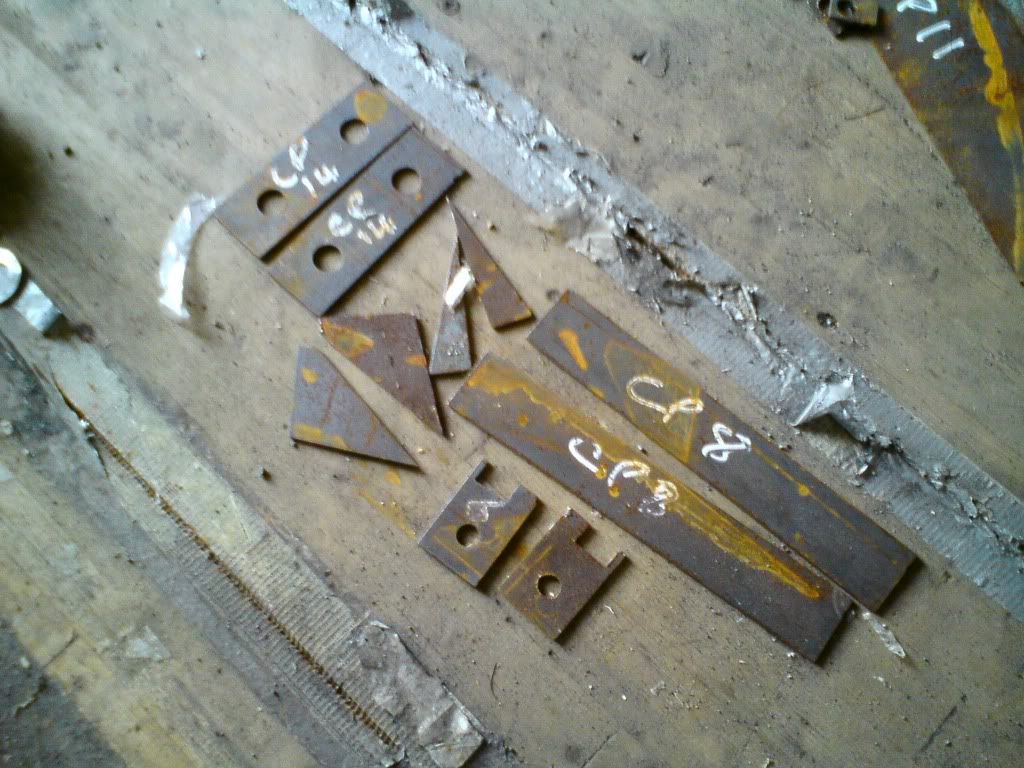

One other question for this evening, can anyone give me a clue to where these plates go? :o
[EDIT] Had a look at some pics, and i'm guessing cp8 goes at the back for the fuel tank to sit on? and one of the cp14s at the back of the transmission tunnel for the handbrake cable. What about the others??
Eternal 23rd July 2010 09:46 PM
cp14 goes in the center area of the diff cant remember what its called now... anyhow it holds he handbreak cable ect, The large triangle plates with the edges cut are for the ally rear tub same with the little squares with holes. dont have the book to hand but if you look in the rear tub section you will see them. As for the long triangles cp24....... well i have yet to find out :D

Great. Thanks for the help. Do both CP14s go in the diff area?

I think you only need 1 cp14 for the handbrake:)

CP24
front of engine bay
where the engine rails meet the outer rails
they are like a fillet to reinforce the join
br1-br8 and br2-br9
cheers les g
ozzy1 24th July 2010 01:31 PM
cp 14 - 1 off req to locate handbrake cable(slot both holes to slide cable in easily)
cp9 - 2 off ( square with square cut out & hole in) roll bar support plates
cp8 2 off fuel tank supports
cp25 2 0ff (larger triangle) below cp9 to strengthen cp9 supports
cp24 as les g said

CP9 & CP25 only needed if you are fitting an ali rear tub, but if fitting a GRP tub you,ll need an extra frame layout to attach it to ( see other thread/posts about the layout).

Thanks for the help guys, spent ages today holding the little triangle all over the chassis, then finally found it!
