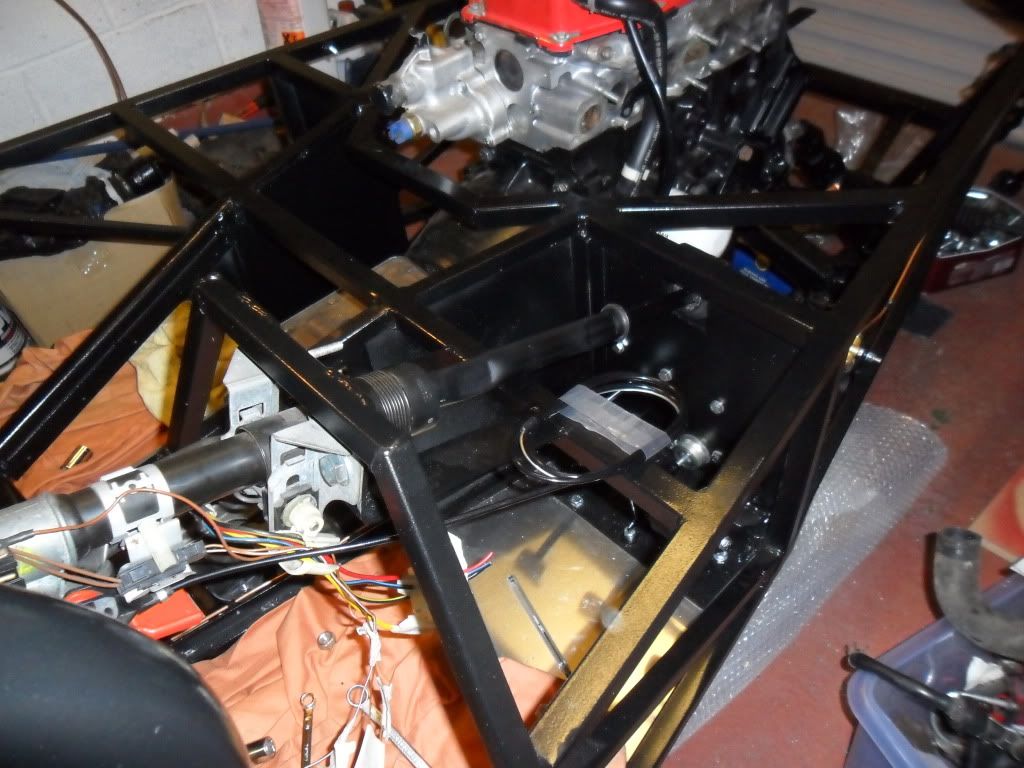

Hi all, thought it was time for a quick progress report.
Nearly 4 months to the day that my chassis was started, it is all finish painted, ready to be taken back to my garage.
Cannot thank forum member Gus, enough for the hard work he has put in making my chassis with me during our half hour lunch breaks. At least his shopping bills have been cheap. Didn't give him time to eat!!
Attached are a few pics of the chassis & cage all painted and assembled.
Sorry if they are a bit dark. They look better on the camera.
Dave

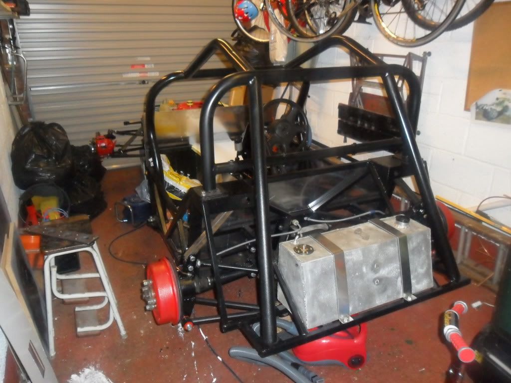

HandyAndy 17th August 2010 11:42 PM
WoW looking nice :cool:
Dave / Gus..... May I ask ......are the roll cage back stays & front down tubes welded to the chassis at the bottom?
reason I ask is that I,ve recently done mine but bolted them in with 4 bolts similar to the upper roll bar mounting, just in case I ever need to remove the roll bar.
I take it you both only have time for a kit kat in your lunch breaks, chassis is looking really nice :cool:
cheers
andy
davedew 18th August 2010 08:19 AM
Thanks for all the comments guys.
I'll be glad to get it home to spend a bit more time on it. Not that i'll get much with a 3 year old boy to play with.
He does like cars though. He was sat in Gus's at the weekend eating biscuits, and getting crumbs all over the place!!
Andy the rollcage in completely bolted into the chassis. The rear stays each have 2no. M8 bolts welded into the bottom of them, which bolt through plates welded to the chassis rear frame. The front tubes each have 3 fixings which go through a plate welded into the corner of the chassis. These bolt will eventually go through the ali floor and a spreader plate underneath.
Yesterday was the first time the rollcage had been back on the chassis since we welded it all up. Went on like a glove and all the bolts went in first time.
Dave

Deanno 18th August 2010 10:13 AM
great looking chassis but arn't you missing RP1 and RP2?
davedew 18th August 2010 10:15 AM

davedew 18th August 2010 05:55 PM
Deanno,
I will be using the grp rear tub eventually so do not need RP1 & RP2. Well spotted though.

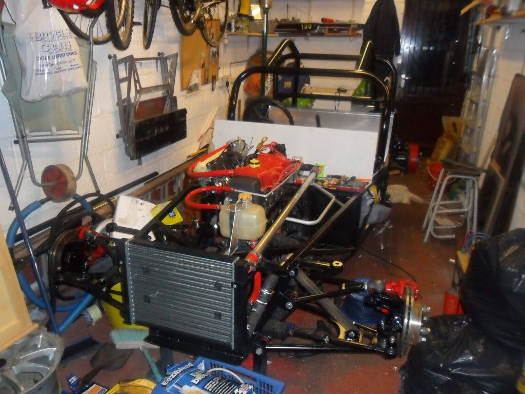

davedew 3rd February 2011 11:06 PM
Progress Update
Well it's been a while since I posted any updates, so thought I best get out of the garage and upload some pictures.

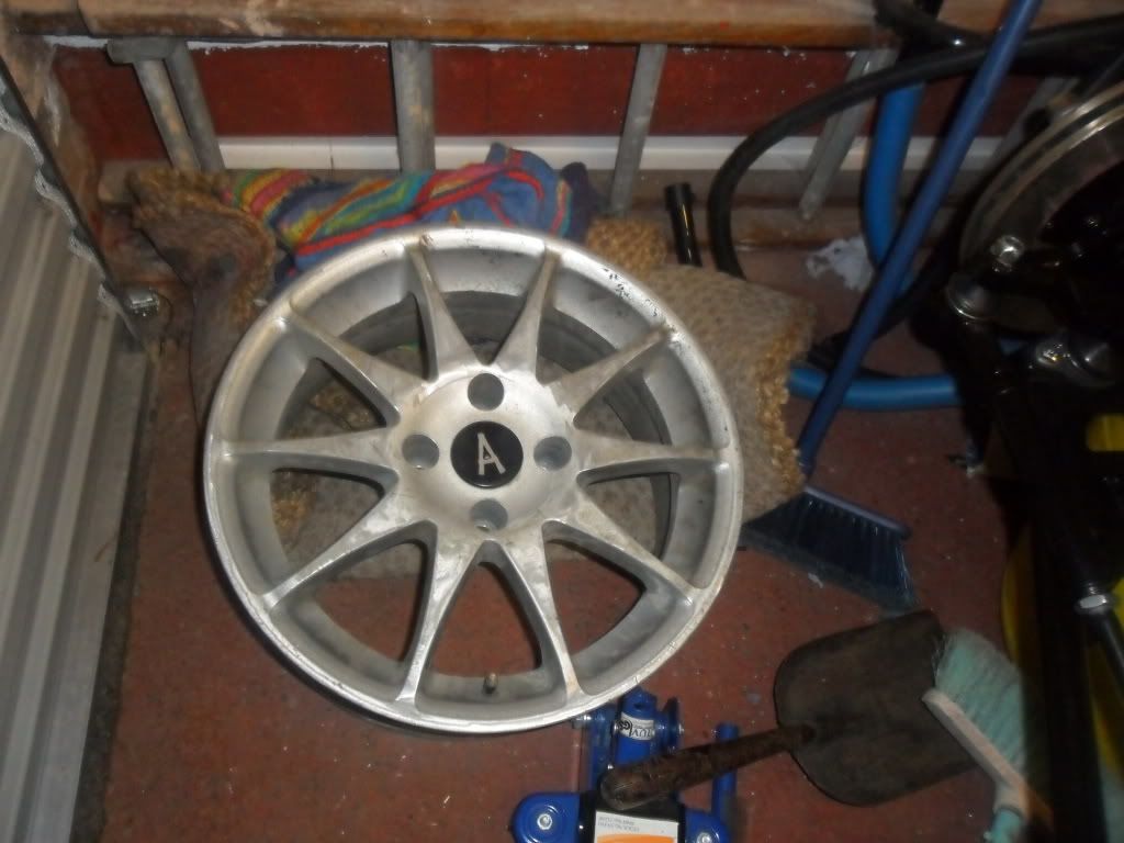

With christmas & my birthday having just gone the fairies have been busy dropping of parcels. So far I have finished the engine coolant, and breather systems. Fuel system complete, horn fitted, brake flexi's, calipers rebuilt etc etc. Loom from Premier Wiring has also arrived.
Deal of the week has to be the 16" alloys I got. Set of four, with only two tyres, but I can source the other two some cheap enough. Got them off a friend at work for £40. They need a repaint, but I will put them through our sand blaster at work. Lucky for me we have got a job in at the moment using 2pk traffic black paint. Guess what colour I wanted my wheels?
Below are a few pics for you comments.
Dave

Spikehaus 4th February 2011 06:41 AM
What size are the wheels? they look like they are 14" ? If so have you tried them on the rear uprights? Should look great when painted up. I am looking at the bespoke centre caps you can purchase off ebay, to add that finishing touch!
davedew 4th February 2011 08:10 AM
Andy,
Gus and I made the cage as I wanted something a little different. Never really thought about making anymore. John at 3ge did ask to use the plans to market them, but don't think it ever got off the ground.
Spike the wheels are 16" so no problems with them fitting over the rear uprights, I did try one on though just be sure.
Dave

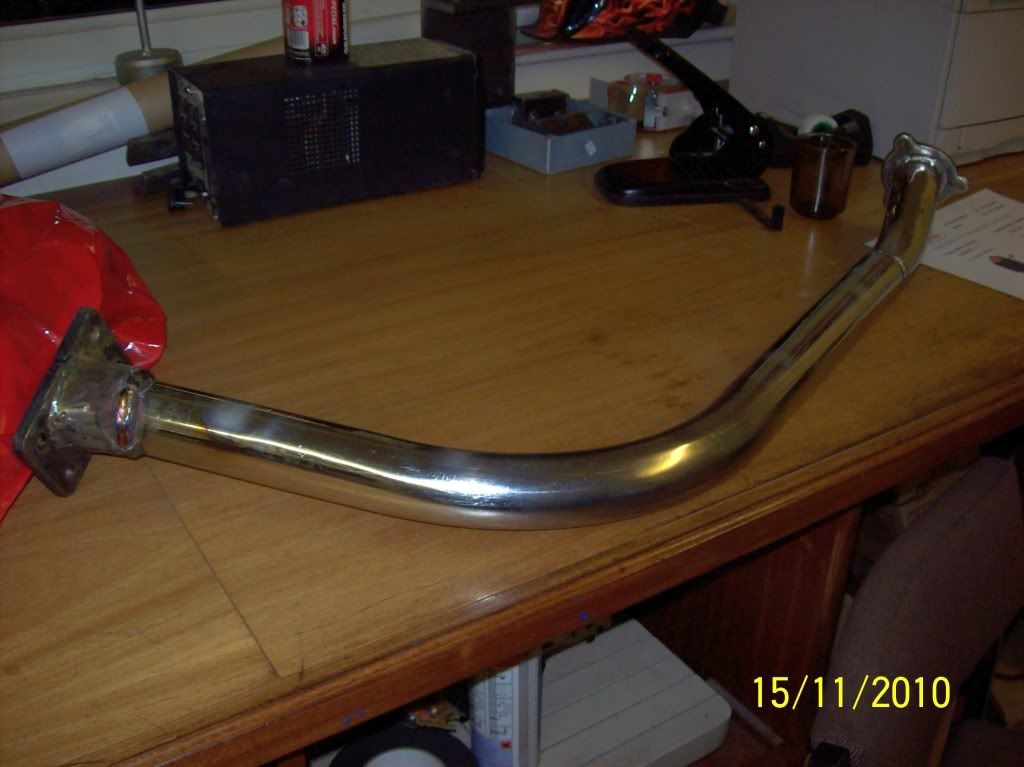

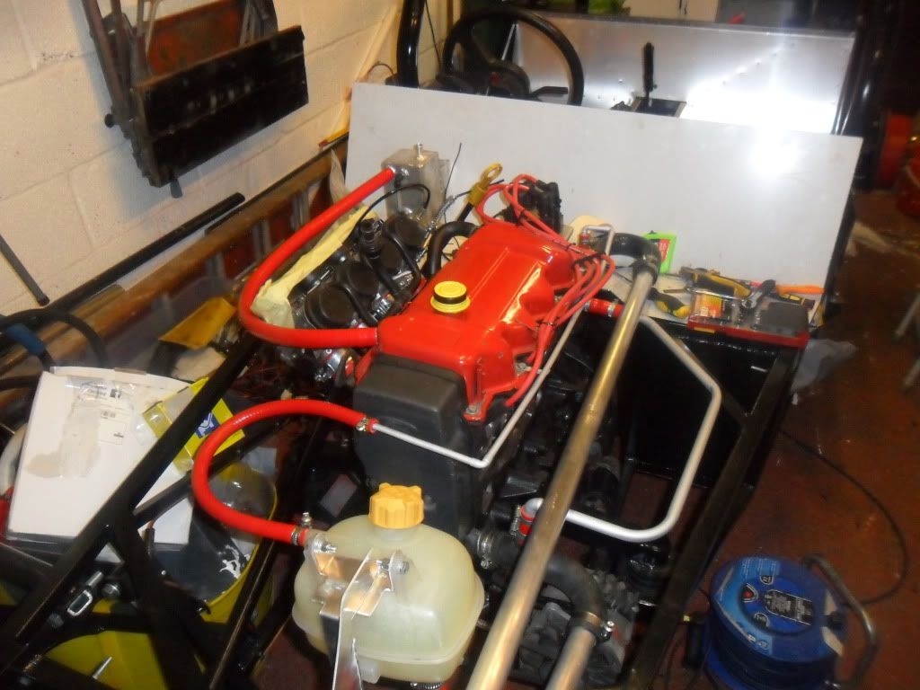

How have you sorted the cooling on the cvh, blanked off manifold outlet and escort thermo on the back. A couple of pictures in that area would be good!
davedew 7th June 2011 01:05 PM
Just for you mike here are some of the pictures you asked about.
Like you said. Take core plug out of head & fit FWD thermostat housing. Manifold flange for bike carbs covers over the original water outlet, and I have fitted the sensor for the Acewell dash in the same position.
You may notice in the first picture that I dog legged the chassis rail around the housing.
MikeB 7th June 2011 02:18 PM
Thanks dave.
Thats how I'm doing it, I've tried to notch a bit out of the chassis rail and added a peice behind to add strength back, I wont know if the notch will work untils the engines in an revved up under load, as I've got the extra bit already in I can always cut the orginal rail out if it fouls,
What carbs are you using?
Where did you get the manifold plate from?
Is there a cover for the part above the old water outlet (not sure what it is two bolts)
davedew 7th June 2011 02:37 PM
Mike,
This is where work comes in handy. Being a CAD designer I drew up the manifold plate from a gasket & we have a CNC flame cutting machine at work so I cut it myself.
The carbs are GSXR 600 carbs with a TPS. The manifold has been remade since this picture. No matter how hard I tried the carbs kept falling out of the silicon hoses so I bought the proper inlet rubbers.
I then had the manifold skimmed on our mill at work to get it perfectly flat both sides.
The cover you mention is where the fuel pump should be, but my engine started out as a CFI engine so had no fuel pump fitted, and that is how Ford blank the hole in the head.
Hope that helps, any more questions feel free to ask.

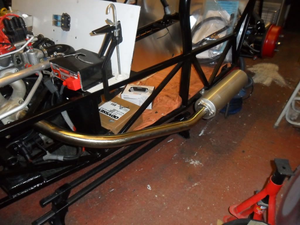

Which way are you heading for the exhaust, that doesn't look like the standard sierra manfiold or down pipe,
M
davedew 7th June 2011 04:17 PM
Manifold is a series 2 Escort turbo manifold with an adapter plate between it and the head. Exhaust can is a Suzuki 1200 Bandit can with a custom stainless steel pipe between.
Again all made at work and polished by my own fair hand.
The outlet of the can is rolled so will pass IVA but aims towards the rear arch. Providing the arch doesn't get damaged by the exhaust gas it should all be fine.
The exhaust is actually quite quiet. It's the carbs that make all the noise when the engine is running.

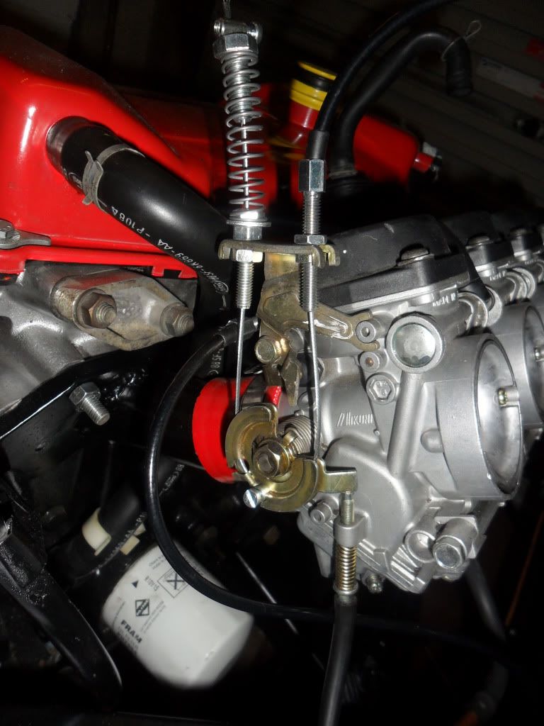

baz-r 7th June 2011 05:59 PM
looking good but whats the deal with that odd push pull setup you have on the throttle cable?
the back cable was where the return cable would have been for the twist grip
what is the deal with the spring and stuff?
davedew 7th June 2011 10:06 PM
Baz. I found that the throttle was lazy closing due to the extra weight of the pedal. By adding an additional spring the throttle closes more positively, and means the coil spring on the throttle spindle does not have to work as hard.
mark 8th June 2011 02:51 PM
A squirt of wd40 down the inner of the throttle cable really helps too, mine closes like a rat trap!
