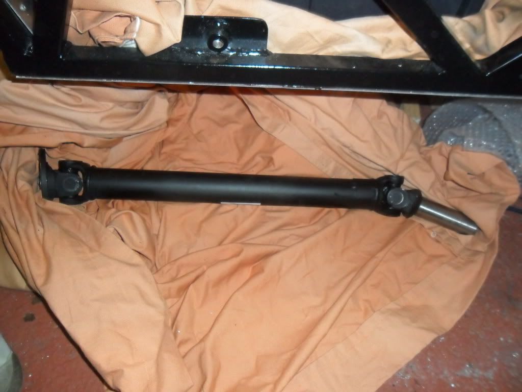

Looks like that one has been answered, my prop was a heavy duty version so it cost a bit more, about £120 delivered, it was sent overnight courier!
For info it was:
700 mm L x 50.8 mm Dia Propshaft, 35 mm dia x 25 Teeth Sleeve, 4 Bolt flange
I am sure they will help you out,

davedew 1st February 2011 05:41 PM
Wim,
Below is a picture of the prop I got from NWP. If you tell them what gearbox & diff you are using, and the distance from the diff flange face to gearbox oil seal and they do the rest.
As said before made and delivered within 24 hrs. Quality product & price.
Prop is one piece with two UJ's.
