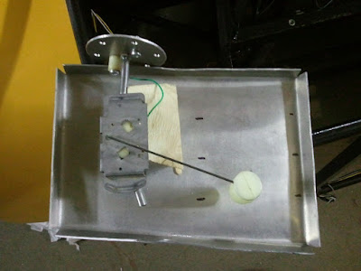

My cap is positioned like this:
I just integrated a ~13x13x7 cm rectangular swirlpot to my tank. That's 1 litre of fuel, should be good for 10 km or so ;-) The hole from the tank to the swirlpot is about 1-2" in diameter and is central to the pot. The intake is also in the swirlpot's bottom center, and the return comes to the swirlpot rather than tank. I had no fuelling interruptions with this setup even with the tank near-empty.
Since I use the Sierra cluster for now, I used the Sierra's sender, too. In the carbed Sierra, The sender sits on the fuel pickup pipe. I cut out a part of that pipe and made an adapter for the 6 x ø60.7 (or what's that standard fuel sender PCD) fiment. The length of the float arm fit the book tank almost perfectly.

Josh 3rd August 2013 05:08 PM
Thanks for the info Albert, plenty for me to digest!
What thickness and grade aluminium did you use to build your tank? I have enough 2mm ali left over from my floor sections to fold the main section of the tank, but I'll need to source more to make the end plates/baffle/swirlpot.

I used the leftover 2 mm half-hard. People commented that it's overkill. And, yes, 2 filters: the tin can one after the pump and the cheap plastic one before the pump!
