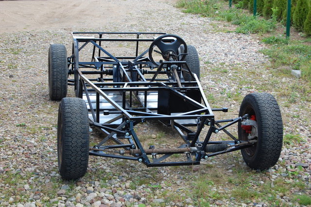

Hello,
Chasis - same as in the book.
Engine - electric same as in the honda.
Other parts - Ford sierra.
Planing weight 350kg.
Planing 64kw and 200Nm. :rolleyes:

I'm wondering, where did you get the weight estimate from? A typical build is around 550-600 kg. Remove the engine, tank, gearbox, and you still have around 380-430 kg. I tried summing up the weight of my rolling chassis, got around 240 kg at this stage:
Do you have any weight-saving ideas in mind?

mr henderson 14th November 2010 03:58 PM
Originally Posted by alga (Post 48713)
This is off topic, I'm afraid, but are you planning to change that steering rack at some point? It looks like you are going to get some bump steer, judging from where the passenger's rack ball joint is in comaprison to the suspension pivots.

jstskn 14th November 2010 08:22 PM
henderson: yes, he will change it to escort mk2. it's temporary
