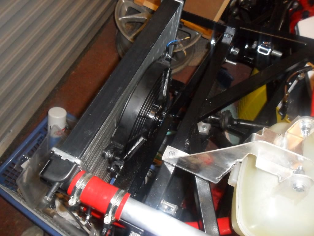

brainbug007 26th August 2011 08:44 AM
I decided to stick with the sierra bottle and managed to get a bracket made to hold it on. Is it considered ok to bolt the bottle to the bracket and then rivet the bracket to the chassis as wasn't there something around when you couldn't use rivets to attach things for iva?
