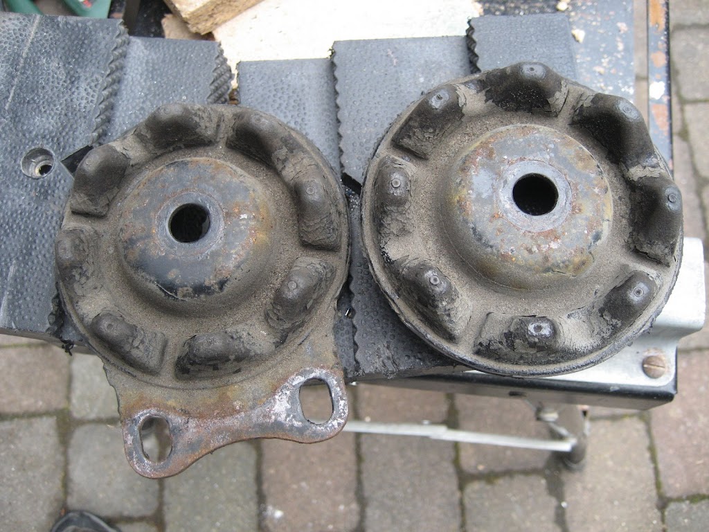

Hi all,
This may be a dumb question but there is a large rubber stop washer under each side of the diff mounts on the donor car. I have checked through peoples builds and don't see any brackets on the chassis for refitting these. The question is
"are they to be left off and what are they for on the donor car"?
I guess Mazda put them there for a reason and I myself have fitted brackets in case I have to fit them but cannot find any new replacements as the original ones are a bit shabby to say the least.
Any ideas?

skov 13th January 2012 02:55 PM
I think he means these rather than the rubber inserts in the diff itself:
They bolt under the diff mounts and act as bump stops, and I guess stop the diff falling off if the diff rubbers fail!
I plan to fit them to mine, but just via the hole in the middle, and won't bother bolting the two extra holes to the chassis.
I've seen them bolted on upside down on a Westfield build which makes them press against the diff giving it an almost solid mounting:
Johno 15th January 2012 08:22 PM
Hi Ozzy1 and Skov,
Their the ones John, I meant to post a photo of them but you beat me to it. I've welded a bracket to my diif mounting plates to pick up the holes for the metal plate on the washer. I've tried to source new ones but had no luck as mine look a bit tired to say the least.
