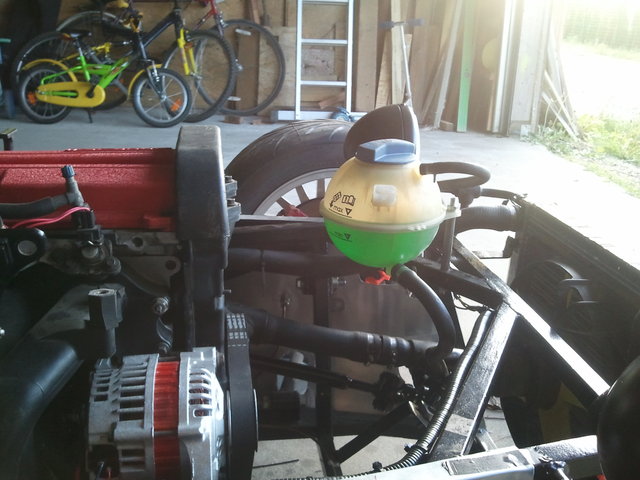

alga 11th June 2012 09:27 PM
I used a spherical VAG header tank off some Škoda. Apparently, similar ones were used in Passats and many other VAG cars. You can get a new one for ~10 quid. I didn't pay too much attention to the pressure cap, but they are standard service items, available in a range of pressures, I'm sure.

alga 11th June 2012 09:56 PM
The fluid level in the tank is several centimetres above the vent point on the thermostat housing, which should be the highest point of water in the engine.
So it should be fine, I think.

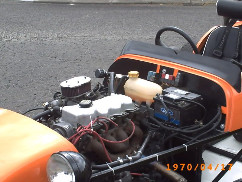

HandyAndy 11th June 2012 10:03 PM
I,m intrigued :confused:
Why fit the header tank under the nose ?
My thoughts are ......once the nose is on its then very difficult to remove the cap & top up ,
For this reason I have fitted the original Sierra header tank on the scuttle bulkhead panel, its high up & easy to get to ......or am I missing something ?:confused:
heres mine below

Steve.......Ah, ok then I see your point :) , I must admit that installing the hoses to mine was a bit of faff on but it seems to work once it was all done .
In all honesty the reason I positioned mine where I did was after seeing Spud,s setup which is under the N/S of the nose & seeing how difficult it appeared to get at ( sorry Spud :p ) & also I tried to get my header tank as high as possible :)
