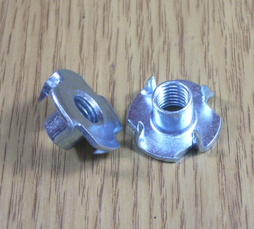

I've got a plywood dash, and I'm using M6 T-nuts to fix it in place.
The bolts go in from the back and pull the dash against the scuttle.
I'll cover the dash in padding and vinyl to hide them at some point.
