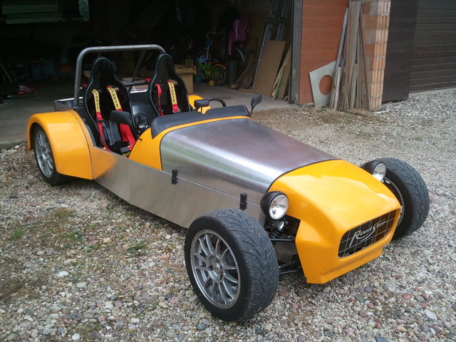

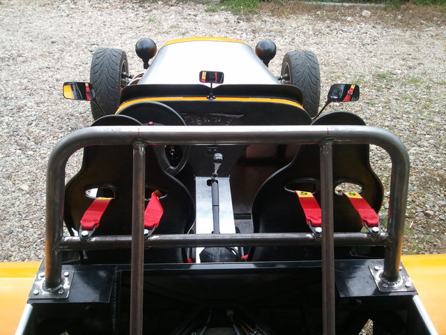

alga 15th October 2012 11:56 PM
I took the el cheapo ones, well, they are el cheapo. I had to get M10x1.25 nuts to fasten them, the mirror surface is not ideally flat, and the articulating joint is not great (tends to spring back to the middle position). But they look kind of OK and the price is right.

alga 21st October 2012 05:06 PM
Initially the mirrors were quite flimsy, but then I added ~70 mm diameter load spreading "washers" out of 2 mm ali on the inside, they helped a lot. These mirrors are not E-marked, but looks like that is not a requirement for IVA.
As for the side repeaters, I left them out for now. They must be mirror mounted or wing-mounted (and visible from the back) in order to pass the ECE requirements. Another silly idea I had are scuttle-mounted motorcycle stalks pointing upward.
