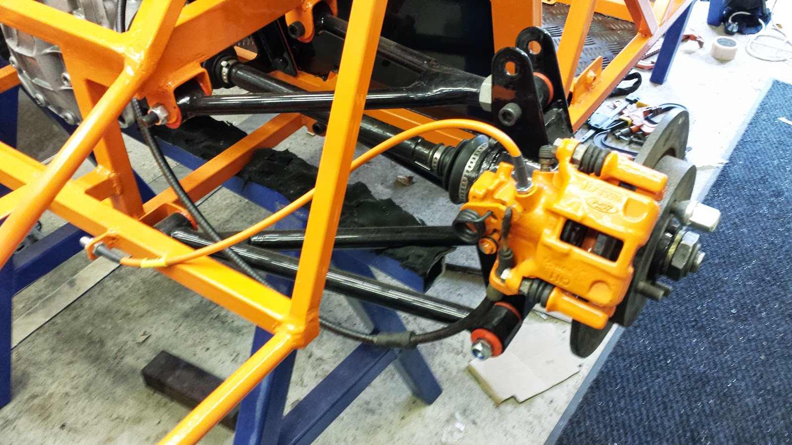

Looking good and your making great progress.
One thing I noticed is your single fixing for your roll bar stays. This was a iva fail early on for AshG so you may want to consider changing that.
Also the rear brake lines are fowling the chassis, I don't know if that has been sorted since this pic.
Steve
