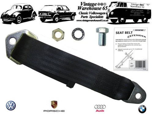

They have these things on ebay,
Those wont be e marked but they work on the principal of my metal straps so I hope it might be a good solution.

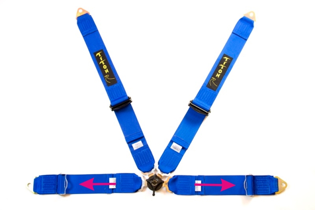

Thanks David, the Sabaelt ones do adjust how I would need but @ £170 each.
Prima have told me they do a 'Reverse' lap fitment which is what my picture is showing. They are £107 each which is more palatable but it still irks me to have to spend that much.
