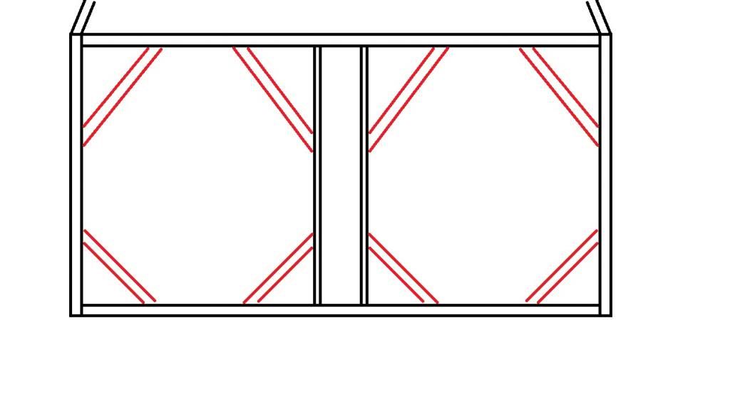

One way round this problem of not having the seats is to make the mounting tubes universal, if you stop thinking of every thing being 90' to every thing else then it frees up some options. If you weld the tubes solid around all four sides you can then just drill through and bolt them in later.

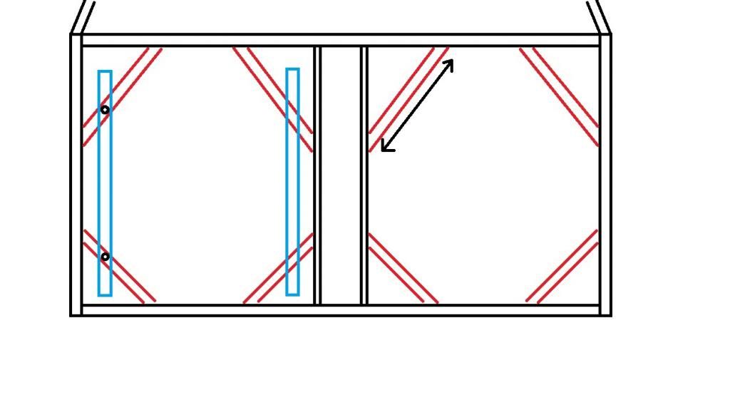

Old 9th September 2013, 08:30 AM
That doesn't mean that the holes will line up you get either the front pair or the rear pair but that doesn't mean that the other pair will come in line with your steel work and if it doesn't then you will either be cutting half of what you have already done to move it of adding even more steel and weight.
The only real benefit I can see in that is you are adding triangulation to the floor.
just my humble opinion.
Old 9th September 2013, 08:40 AM
If your using seat runners then you can put the bolts through the channels, most of them seem to be around the same sort of length. You don't have to use the holes that are in the seat runners as standard you can drill more holes in them. It's not about getting the holes to hit the middle of the tube at a predetermined point it's about making the build process more flexable.
Old 9th September 2013, 09:07 AM
It's as long as it's broad no real benefits as you have got to drill 6 holes instead of 4 no real logic to it
