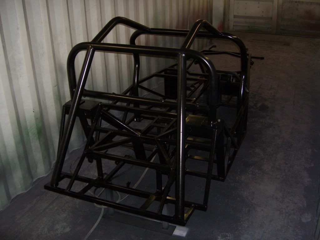

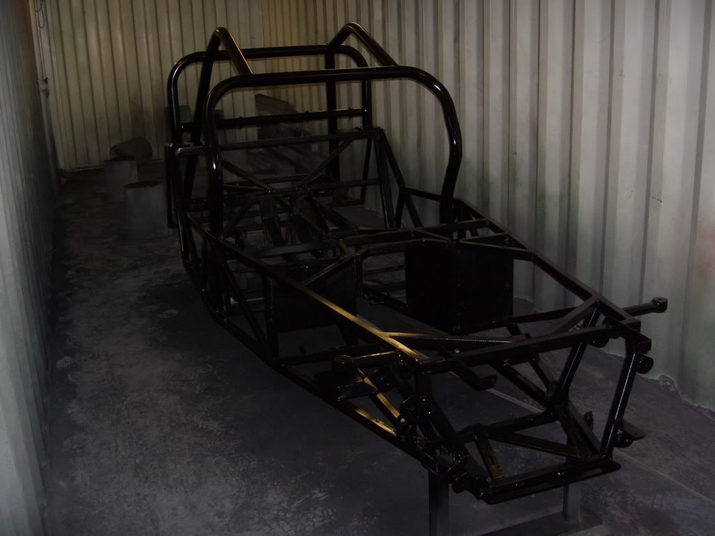

Hi all, thought it was time for a quick progress report.
Nearly 4 months to the day that my chassis was started, it is all finish painted, ready to be taken back to my garage.
Cannot thank forum member Gus, enough for the hard work he has put in making my chassis with me during our half hour lunch breaks. At least his shopping bills have been cheap. Didn't give him time to eat!!
Attached are a few pics of the chassis & cage all painted and assembled.
Sorry if they are a bit dark. They look better on the camera.

Dave / Gus..... May I ask ......are the roll cage back stays & front down tubes welded to the chassis at the bottom?
reason I ask is that I,ve recently done mine but bolted them in with 4 bolts similar to the upper roll bar mounting, just in case I ever need to remove the roll bar.

Andy the rollcage in completely bolted into the chassis. The rear stays each have 2no. M8 bolts welded into the bottom of them, which bolt through plates welded to the chassis rear frame. The front tubes each have 3 fixings which go through a plate welded into the corner of the chassis. These bolt will eventually go through the ali floor and a spreader plate underneath.
Yesterday was the first time the rollcage had been back on the chassis since we welded it all up. Went on like a glove and all the bolts went in first time.
