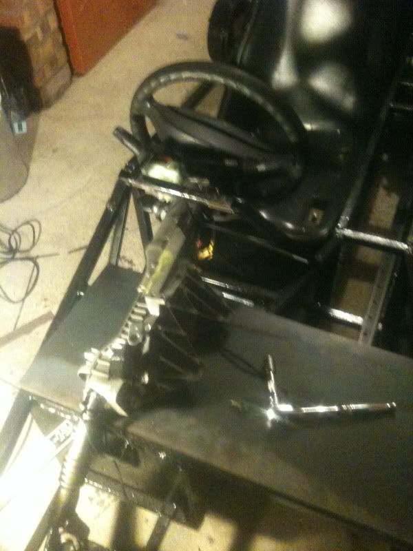

I have just removed my sierra column and il be fitting the mondeo column for the following benefits:
Its adjustable for tilt and legnth ( im pretty short and my seats look rediculous pushed far forward)
It has more modern looking indicator stalks
It has a nice key which doesnt look like it belongs to transit!
On the down side it isnt quite long enough for the bearing to reach the bulk head and the mountings are a large cast alloy block.
I believe that no one makes a boss for the modeo column but they cant be that hard to make on a lathe.
I think iv found a way of getting it to fit with alot of head scratching, a bit of chopping and making some new mounts. Its a lot of work but i really want to have the adjustability so il make it work and then put up a guide with measurments and bracket dimensions etc. It might tie in nicely with spuds plans for using other donors. He might even be able to make the brackets hint hint
PS i now have a sierra column going cheap with a brand new lock and key (no cowels)
a quick pic for reference

a bit of progress today,
I mocked and tacked the hanging bracket that will also form half of the shroud around the column( this is currently 1.5mm sheet but once ive got the dimensions correct il make one from 3mm plate cos its abit spongy). Iv decided to take the column over the top rail rather than through the bulkhead because it would be impossible to fit without cutting TR9. It would also make the steering wheel hight rediculous. This will mean losing some bulkhead space but the shroud will have a bit of space for attaching the fusebox. Iv addded a 25mm box tube between tr8 and tr9 to which a fixed flexible bearing is attached to plates welded onto this tube.
below is the other side of the shroud, im going to cut out around the column so that it buts up to the other bracket and sort of forms part of the bulkhead.
When i fitted the sierra column i was very worried about clearance between the lower column and U2. Moving the column over TR8 has solved this problem, but until fitted, i dont know by how much.
If theres others who are struggling to get hold of sierra columns, or maybe want just to use the mondeo one instead i will do a howto with plans and dimensions etc and post it up.
Nathan
A few build photos... www.photobucket.com/ntsengineering

Nice work Nathan, looks great
May i make one suggestion? ( sorry )......the extra piece of 25mm box tube between TR8 & TR9......it might make it easier for fitting the scuttle if you positioned that new steel so that its welded to the inside face of TR2 & TT2, then build up with some plate or more box tube to fix the column bearing to it.....just a suggestion , just thinking further on in the build with the scuttle placement.
Well done on solving the new column fitment

quick note, i used the sierra column but ran it over the top of the pedal box like you have, the problen i have now is that the steering shaft sits rite were the alternator should be, havin some probs gettin around this at the moment, worth a check before you get too far
