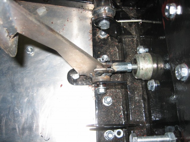

I used a piece of M8 rod and a long nut. It works. Sierra's vacuum has a ~10 mm stud with a screwed on 6 mm spherical nub.
Old 18th October 2012, 05:41 PM
As you can see, I also made my own clevis pins for laughs, out of a 6 mm rod and M6 washer :-)
