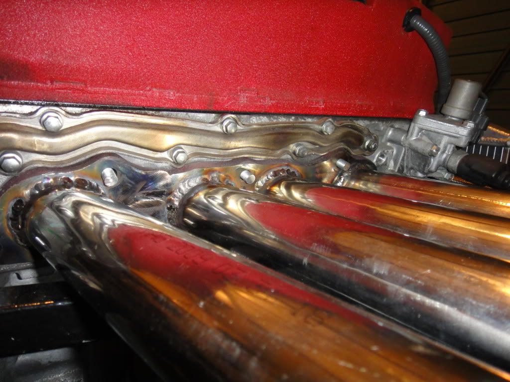

Warning what you are about to see may be considered by some to be an explicit image.

automotive porn indeed
Stunning work Tilly, can,t wait to see the start up video .

thanks andy, it has been running a couple of times very briefly already, i will try and get a video of it when the exhaust is on and i drive it out of the garage or something.

WOW, nice work. Do you make manifolds for a living? The reason i ask is that I'll be wanting a new one pretty soon.

no i dont make them professionally, i would make one for someone else but it would be very expensive and i would need the car to be at my workshop since it would be a one off made to fit manifold.

Thats a work of art ..do you buy the prefab bends or do you have a bending machine ? where did you get the 4 -1 collector from ?

thanks, i do use pre made bends then cut them to what angle i require. wish i did have a bender, i might make one some day as i really fancy one. the collector is actualy a 4-2-1 made from 3 pre made 2 into 1 reducers, i think i got them from a company called jetex, they are ok but are mig welded so dont look quite as nice but they are quite a good price
the manifold consists of 1&3/4" primary's, 2" seconds and a 2&1/2 tail
