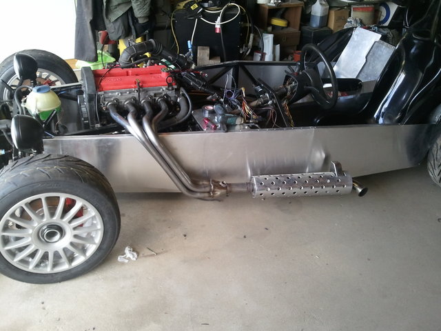

I used the gbs one fine, just needed to put 10mm plates under the engine mounts to raise the engine slightly, see the picky below of it fitted.

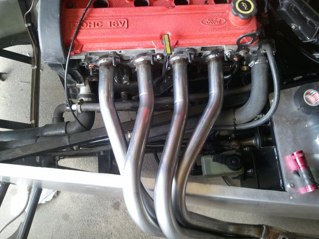

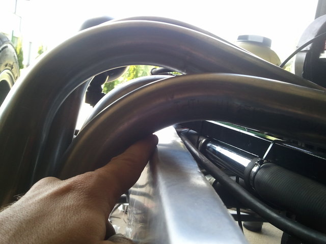

I got the GBS one. The height seems fine, but the runners need to be extended by 4 cm. Go figure! It had a "£175 inc Zetec Narrow" tag tied onto it.
Here are some detail piccies if you want to know what to expect: https://picasaweb.google.com/1008810...itSparesHeader

OK, so GBS sell two kinds of manifolds: Narrow and GT (now both are available on their kitspares.co.uk web shop). GT is 4 cm wider and is a perfect fit for me. My crankshaft is 13 cm above the bottom of the chassis, as per book (bellhousing sticking out by 25 mm)
