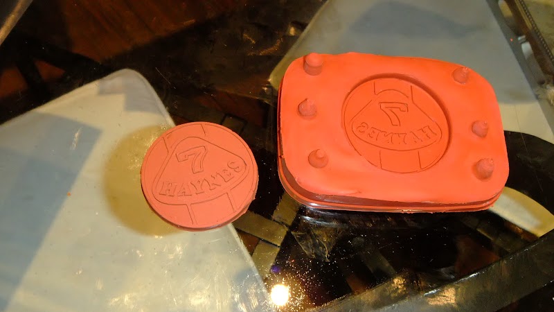

Old 7th May 2013, 10:22 PM
Been through a few options with the badge. The pewter option is proving difficult so Ive gone down the cold cast method which is powdered metal suspended in resin which when sanded and polished, looks like metal.
Take a silicone mold from your master.
Fill with resin/metal mixture.
Sand and polish. The first one was poor so I used it to try out different sanding and polishing techniques, second one had a few bubbles and the last one was much better. Ready to infill with colour now.

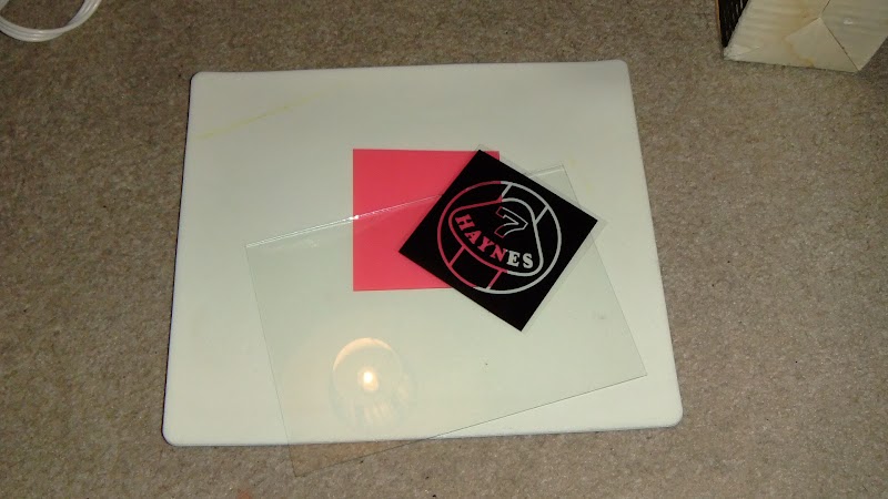

I wont be able to make them for sale, sorry Thailoz. But I'm trying to make it easy for you guys to have a go yourselves!
The other method I was playing with on making a master to take a mold from is photopolymer plates. This is the way rubber stamps and printing plates are made. It is basically a plastic sheet covered in a UV curing resin.
You print a transparency of what you want and expose it onto the sheet so that the UV cures some areas an not others.
I had an old UV sun lamp which was greatm cured the resin in about a minute. You can do it with just a plain halogen lamp and it takes about 8 mins.
Wash out the uncured areas and you have a relief version of the logo that you can take a silicone mold from.
I would probably stick it to a disc of mdf or something the right diameter for the badge so I can get a deeper overall mold.
Oh yeah.. Total time to make this one was 25 mins rather than 4 hours on the CNC, plus you can do more at the same time.
