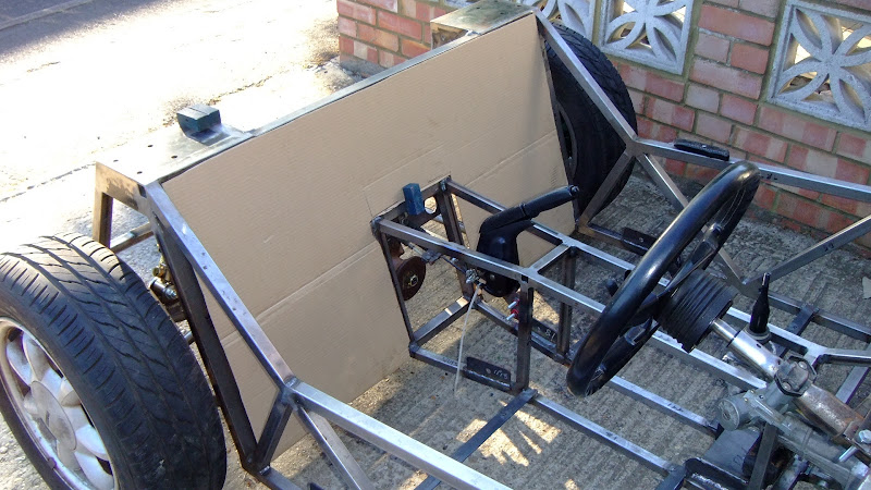

I also started on the panels. Im using cardboard to make templates then cut out of some sheet.
And then I stopped because I should spend some time with my wife....
