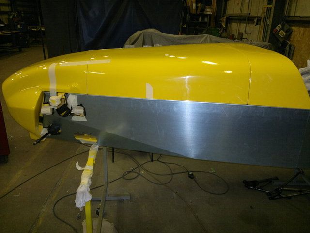

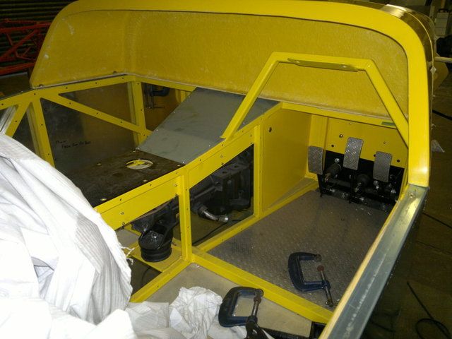

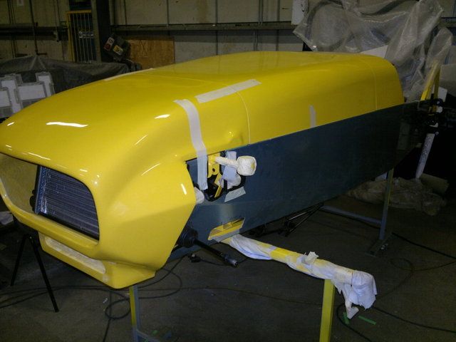

Old 13th October 2012, 08:27 PM
Well I started to fit my bodykit today.
Not worked with GRP before so not sure how to work with it..
I've made a start on the front nose cone cutting out the unwanted panel.
I used a Dremmel with a cutting wheel which seemed to work fine and then sanded some of it back with a drum sanding atatchment.
Also bolted my side panels and scuttle on with riv nuts.
It took some time linning up the ally panels with the GRP kit but it's taking shape slowly.
I plan on fitting my bonnet catches tomorrow which will be be fun I'm sure
