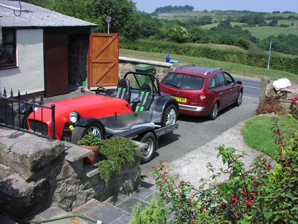

2 yrs 6months then Chadderton ,Manchester tomorrow 8am

Looking good, I'm assuming your going for Iva tomorrow. You need to take the harnesses out I the seats and get them to go around. As the seat becomes structural in a crash.
Also when we tow (same trailer, normally a disco tho) you need the engine at the front of the trailer for better weight distribution

Good luck tomorrow mate have got everything crossed for you, its looking good, don't forget to fill the tank and a gallon in the boot just to be sure
