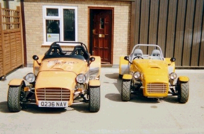

I'm guessing he is using the Zetec out of his 4x4 Mondeo? Also it will have all the suitable driveshafts, if he's using the Mondeo as the donor. Personally I think its going to look exceptionelly ugly. The wide Luego looks like a joke and thats quite wide. 12 inches wider is going to just be against the ethos of a sports car.
Luego Vs a Locost
