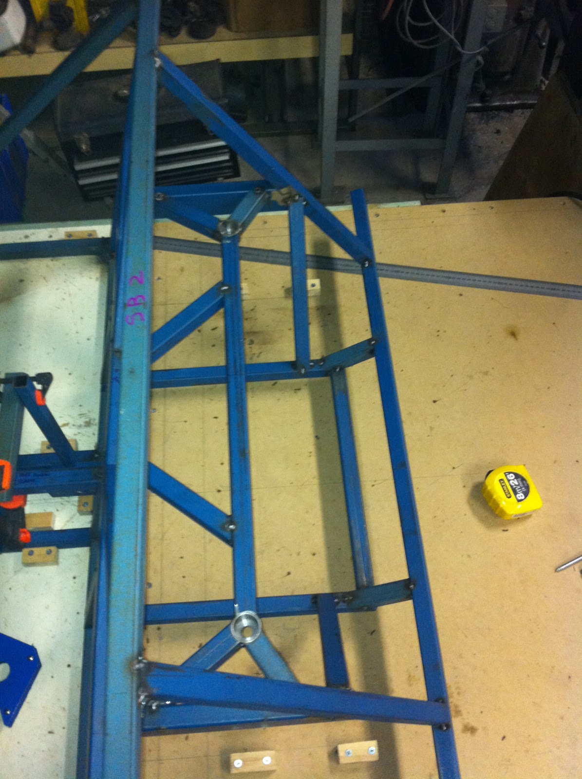

More work done today as i have to go back to work tomorrow. Bugger. So again knuckled down and got as much of the rear sorted as i could. Unfortunately my calculations may have been a bit out as when i lifted the frame into place, it's moved if forward 15mm. Not too sure how it will go, so the MX5 is now up in the air and i've done a few rough measurements on the diff in situ. Hopefully it will be OK.
Next weekends job is to remove the diff and put it into the chassis and check dimensions and clearance. Should only take an hour or so, and then i can attempt to get the engine and gearbox out, split them and start giving them a wash. Hopefully i can lift the engine and gearbox into the frame and also see how they fit. Big plans for 2 days.
The bloke who is going to come and weld the chassis will be coming on Wednesday to have a look at how big the job is. I'm reckoning that there will be at least 2 days of work due to the heat being put into the frame.
And now for pictures . . . . . . .

I would start taking some of that paint off the areas where you need to weld it, you'll have all sorts of fun trying to get a grinder in there once it's all tacked up. How did you find making the diff mounts, did you make a jig to hold all in place or use the 4 pairs of hands method?

A little from column A and a little from column B. Made a jig to get everything in place, and then had to have a bit of a hand holding a few bits to tack them in place. Looks fantastic. Will see about the welds with the primer. My mate should tell me if i've got it completely wrong or not. Anyway it's pretty thing stuff, maybe it can be blasted through with a bit more amperage. Find out Wednesday.

Please don't just weld over the top of the paint or the black scale if using HRC/HRS, if you contaminate a weld it becomes porous like honey comb and you could of just used chewing gum or super glue.

Nice work there mate, good to see the design start to get produced! I agree with Phil about the metal though - it can never be too clean.
