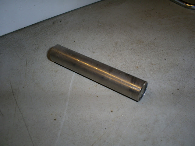

I've ordered some 14mm OD 1mm wall tube to sleeve the uprights and bring them down to 12mm:

One piece of 14mm OD, 1mm wall, stainless precision tube:
mated with one bottom wishbone hole:
A couple of gentle taps with a rubber mallet later:
One snugly fitting bolt:
Job's a good un!
