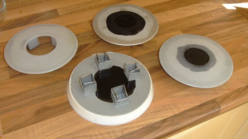

Cheers guys.
I made my hub caps up properly over the past couple of days. I had done a badge in the center of the hubcaps before...
...but I wasn't happy with the look so decided rather than gluing a badge into the hole, I would cast a slightly smaller badge directly into the hubcap.
Using one of my nose badge casts and some body filler I made up a master hub cap and took a silicone mold from it. By placing a hub cap with a hole in it in the mold I could cast the badge directly onto the hubcap.
This is the various stages of the casting from empty hub cap to a sanded smooth hub cap with logo.
  #237
Old 3rd August 2013, 03:08 PM
Then all I had to do was paint them, with some plastic filler primer, white primer, silver wheel paint and lacquer.
The final colour match isn't great so I may try and find a better silver, but they didn't turn out bad!
