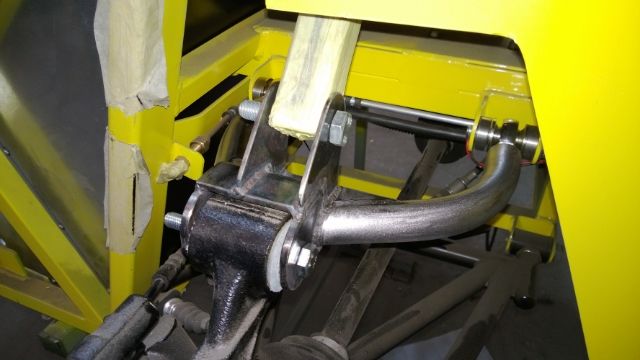

Originally Posted by Johno View Post
Well I've been researching a bit on the net and think I'll be going with option 1.
This should keep the loading on the Rose joints to a minimum.
I guess only time and miles will tell...
Option 1 would be more preferable to option 2. The rod ends would have more bending force acting on them (from acceleration/deceleration) if they were outboard.
One of the best ways though, would be to have an alignment bolt system, like Mazda fitted as OE to the MX-5.

Hi all,
Skov's right, no more ideas please I'm now on Mk5 I think.....
Well I'm glad you agree with option 1 Dave because their nearly finished...lol.
The only thing I'm not sure about is do they need a support between the tubes where they weld to the upright bracket/shock absorber mount if you see what I mean.
On my CAD drawing I have a piece of box between them but I'm not sure if it's needed?
Hi Jason at some point I did think about inboard suspension but I don't know enough about it....
Yeah would be nice having the pipes down the tube would it be OK for the IVA?
So what setup you thinking of making?
Hi all,
(IMO) short answer - I personally would if your CAD is accurate to the real thing.
(IMO) long answer - I suppose it would depend on the design of the upright and the length of the wishbone as well as the damper length you're running (and probably more besides) as you would need to determine the position of the lower damper mounting relative to the upright upper mounting. That area is going to have high load through it. If you are still near the SSC/NTS design in terms of geometry, or if it's similar to your CAD image, I would say it would be worth putting a support plate in, as per the original SSC/NTS design.

Well I've finished my latest design of rear wishbone, Mk5 I believe...
That's it, no more changes or tweaks its done...
Hi Dave,
I kept to the CAD drawing and fitted a piece of 25mm SHS between the tubes and fully welded it to the upright bracket support.
The design keeps the shock length the same as the Saturn spec which is convenient as I purchased some shocks this week to that specification.
I feel a lot happier now with this design as it's a lot stronger than the one I had on the car and is still adjustable. I've upgraded the tube size from 19mm to 25mm to accommodate the weld in Rose joint threaded adapters.
So these are now ready for powder coating.
