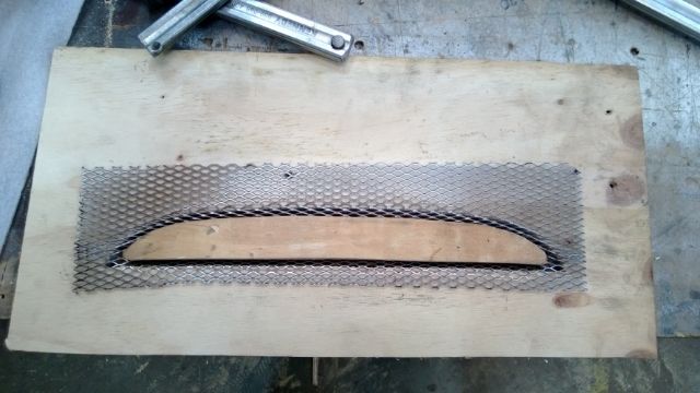

I made my grill for my bonnet scoop this morning.....
The formers were made from 12mm ply with a 5mm gap between the two.
Placed the mesh in place and then clamped down with a bit of support from a bit of box.
This how it tuned out, just needs trimming and a coat of paint ready for bonding in place...

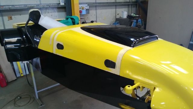

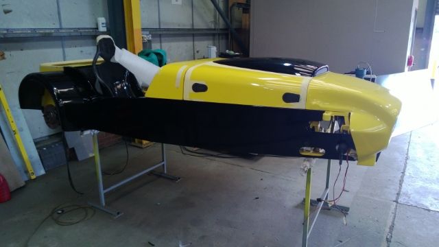

Well at last I've got some stuff done and parts delivered.
I've been spending the last few weeks collecting stuff ready to crack on with it.
Just couldn't resist seeing what it looks like with the side panels rear wings on.
So now got loads to get on with..
