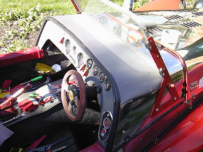

hi from what i understand is you must use the template of you windscreen tha you have made of ply wood or mdf or chip board and use that tool that they show you how to make in the book to bend it but you must heat it up with a blow torch then use that tool and bend it on your template but must do it in one movement so that it comes out smooth with no kinks or anything i hope this info helps you . i also just wanted to know what size is the rail that you use for the windscreen frame ? the other thing i wanted to know is there is this black strip between the windscreen frame and the scuttle i would like to know what yhat is and what is it called and what it is for i have uploaded a picture with a green arrow pointing at what im talking abuot can someone please help me with this info thanks

hi im having a bit of a issue understanding everything about this windscreen cause im all the way in south africa and our stores are not the same so thats why im trying to understand everything and get names for everything so that i can go looking for this stuff and here and is gbs the name of the store or is it the rubber strips and that picture i posted is pointing at some black strip the goes right across between the frame and scuttle .thanks sorry for all the questions im just really confused here

hi axle i just went on that web site and i saw that T shaped rubber strip so im guessing that goes between the scuttle and the windscreen frame now tell me which side must the T part face must it face in towards the steering wheel or the bonnet

Glad to know you got some result! The answer to your last question I suppose you want the rubber to the inside as the curve of the alloy makes more contact between the body and the frame and therefore it makes a better seal. I know the previous pic you send me was to the outside.
Anyway this is the way I would do it, others might have have a different idea I would be delighted to know!
