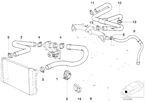

I'm trying to figure out your system. I take it the water is pushed through the heads/block by the water pump to the water rail at the back and then down the pipe in the centre back to the rad. I see the pipe is connected to the pump but I assume this is straight through the pump body to the rad.
Correct me please if I'm being thick but I notice on my tintops (both Zetecs) that the hose coming off the thermostat goes to the top hose on the rad and the pump is fed from the bottom hose. Yours appears to be the other way round.
the pump draws water from the block, and pushes it through 2 external pipes in the vee between the heads to the rear water rail where it flows back into the rear of the heads and round again. The rail also has 2 ports for the donor's heater matrix. The return from the matrix was a Y-pipe witht he expansion bottle on one end, I have attached the expansion bottle directly to this port and blanked the other.
At the front, the pipes from the pump are arranged as per the donor, with the thermostat side going to the bottom of the rad.

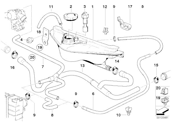

here's a few diagrams from the donor, provided from the bmw parts catalogue, hopefully this will help.
overview showing pump, rad and pipes. What isn't shown are the 2 aluminium pipes which run from the back of the pump to the rear water rail. These are shown in the second drawing, marked 4 and 6.
detail of the rear water rail. the port near bolt marked 3, is the one I have blocked up. The expansion tank is connected to the port marked 1.
and the original setup of the expansion/header tank.

i think this is the same problem i had with my Saab engine. i blocked off the heater circuit and it kept doing the same thing. on some engines the heater circuit has to have a constant flow or it overheats before the stat opens. unblock 3 and either take it to the top of the header tank or splice it into the top rad hose.
a good tell tell sign of the system flowing properly is that you should see water returning to the header tank through the top pipe. if that is not happening then there is something wrong.
