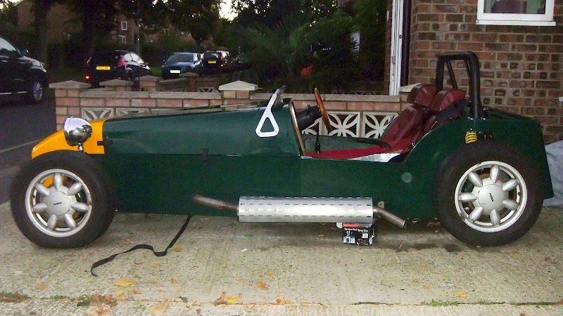

Do you plan to fit the fly/aeroscreen before SVA and then change to full window screen afterwards if so are you going to fit wipers or just take it out on sunny days? I'm thinking about fitting a window screen after the test and what you have come up with is a damn good idea with the straight swap...

Yeah my plan is to fit the flyscreen for IVA then I can add the windscreen at my leisure after that. I already have all the gear for the wipers. I managed to pick up a full wiper set from a Morris 1100 for £5 so it would have been silly not to. Saying that I wont be taking it out in the rain so it will be more for bug removal.

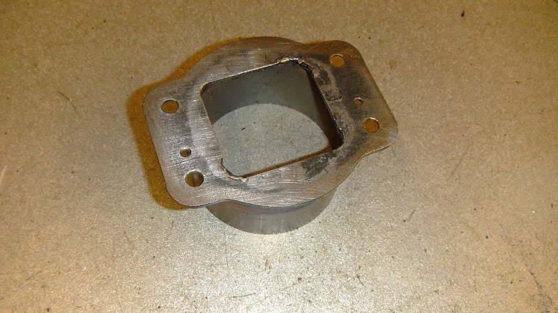

I made an air filter adapter today to suit one of those ASH filters. I cut a 3mm plate to match the gasket with a groove in it to fit a 76mm pipe. Sat the pipe in the groove and welded it from the inside.
Worked out about £22 all in.

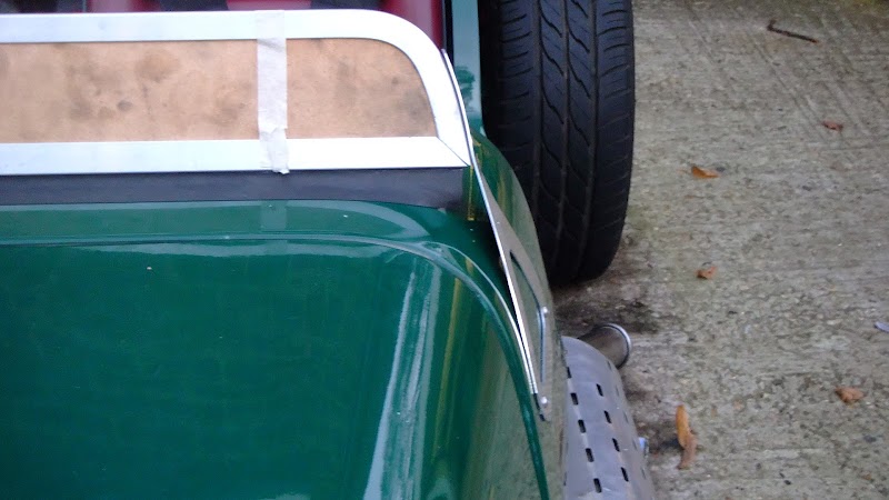

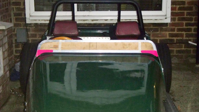

Tried out my flyscreen today. Couple of issues. I have mounted it at the wrong angle slightly. I have some BRG gelcoat so I can repair the holes if they are not hidden by the brackets when its all fitted. Second I need to make the brackets slightly longer in the middle section so I can 'fold' them in to the bodywork a bit more.
I think I will remake them from 4mm or 5mm. Not sure whether to just make some cover plates for the corners or make a solid filler that I can put the seal strip into.
Ill probably end up trying both.

I also carried on a little with my dashboard. Stuck the aluminium parts to the MDF and rounded the edges with a rasp. I added some extra MDF to the back at the bottom so I can radius round a bit.
