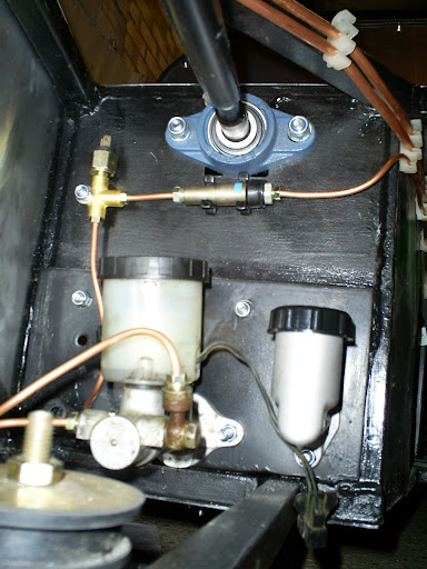

Starting to find some time to work on my build again now.
Managed to finish off the brake lines over the last few days:

Hi Skov. Please can you answer these questions
Where did you get your brake hoses from?
What have you installed after the t piece in the brake line above the master cylinder?
Also where did you get your hydraulic switch from? are you using part smd426?
  #294
Old 18th April 2012, 12:01 AM
Thanks TT. I'm quite happy with how it turned out, just worried it's going to p!ss brake fluid everywhere when I fill it up
Hi David, I had a feeling someone would ask about that bit after the T-piece in the rear line. It's a rear brake reduction/bias valve from a Ford Mondeo (Ford part# 1113275).
The donor one was a bit awkward/cumbersome to use, so I junked it for the Ford one as it's nice and small and simple.
I know the Mondeo weighs twice what the roadster will, but it has two fitted - one for each rear brake, so I figured a single one for both rear brakes would be about right
I got the brake light switch from ebay, here's the details:
And finally, the flexi lines came from Furore. I was very impressed with their service; they were custom made to my specifications and arrived next day! Very reasonable at £15 per line too.
