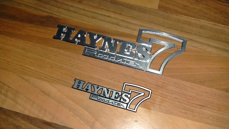

I cut the badge today. Had an issue with it moving on the last cuts so its a bit funny at the right of the 7 and top of the S but nothing major.
Freshly cut.
Painted and polished.
Unfortunately its too small for the back of the car. It needs to be almost twice the size to suit really so maybe ill put it on my dashboard.

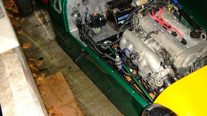

All my engine bay and front lights wiring is in place now too and zip tied to the chassis rails.
Ive trimmed up my nosecone grille too, looks like the nosecone has a slight twist in it to me too as the top is level in this pic but the grille hole seems to be lower on the left.
Still I couldn't have made that part better myself.

I made it from some 1.2mm aluminium sheet I had left over and I stood and watched it squirting it with WD40 every now and then for 1 hour 16mins..
I made its big brother today.
This one is 1.5mm sheet and should be a better fit for the back. The tool paths on this one were simpler so I don't have such sharp points where the lines meet but as its bigger they don't need to be as sharp to look good. This cut the machining time down to 1 hour 6 mins for something thats twice the size. I just need some more paint to finish it.

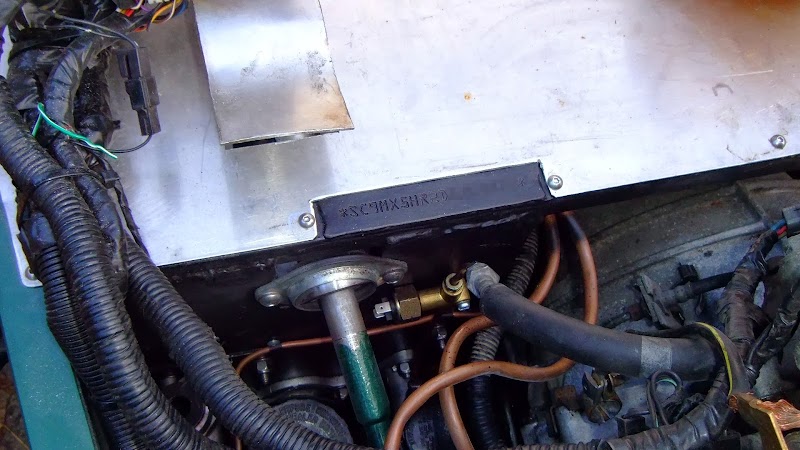

I welded my chassis number in this week. Really should have done this before I painted the chassis!

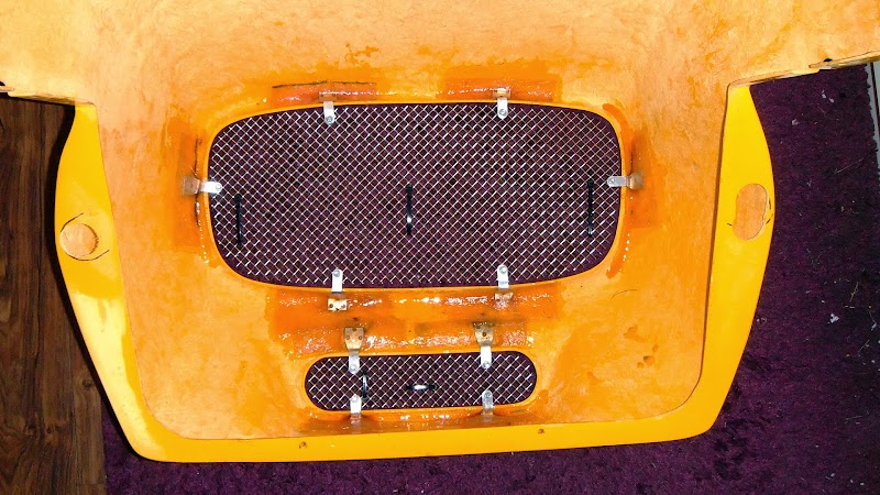

And I bought some jaguar style grille. Needed a nice way of mounting it so I cut some aluminium tabs to be fiberglassed in. They have rivnuts in the end for the grill to screw on to.
Ill finish the edges of the grilles with some chrome U trim to give it a fitted look.

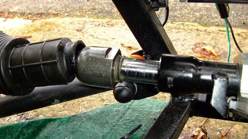

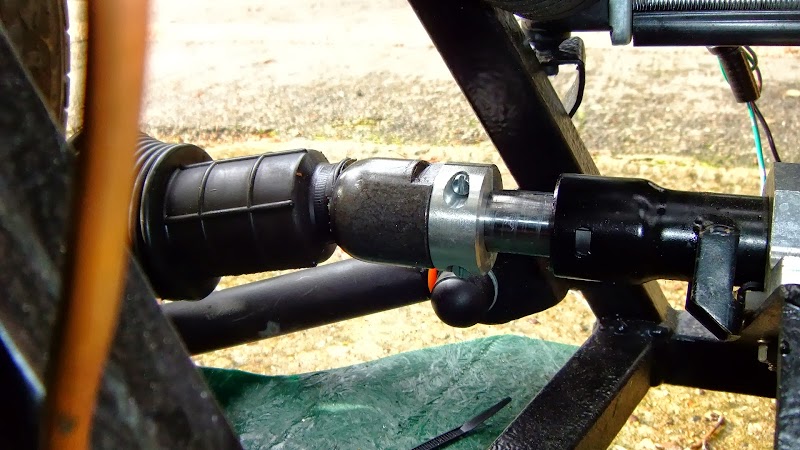

However in the mean time, I made some lock stops for my steering rack.
The step in them is to sit over the threaded end part.
They are sized to match the original knuckle so slip inside the tube this end as needed.

You have just reminded me that I need lock stops on my car. i may just fit jubilee clips for now
just as matter of interest it passed IVA with front cycle wings touching the headlamps at full lock. They checked it with me in the car and when I was asked to move the steering from lock to lock I suddenly remembered . I made it look as if it had reached the end of its lock and no one seemed any the wiser
